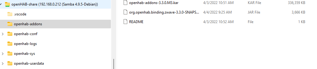

The solution that worked for me was:
  1. remove the existing z-wave binding via the UI
  2. from the Karaf executed: feature:install openhab-transport-serial
  3. dropped the z-wave snapshot jar file into the add-on folder
  4. waited a minute.
Everything then worked fine.
Sorry for any confusion. The only uninstall that needs to be done is using the UI before you add the snapshot binding in the Addons Folder. You don’t want two zwave bindings trying to run (if that is even possible).
