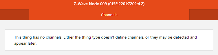

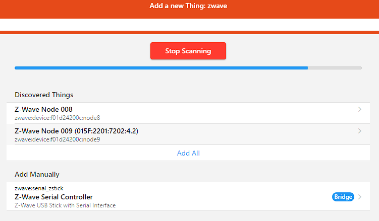

I’m attaching the screenshots from Basic UI showing the Thing details along with its code, also the tail-f logs, where the two lines highlighted below caught my eye but don’t know what it means to require:
2023-10-25 03:03:36.934 [WARN ] [wave.discovery.ZWaveDiscoveryService] - NODE 8: Device discovery could not resolve to a thingType! 015F:2201:7202::4.2
2023-10-25 03:08:01.768 [WARN ] [wave.discovery.ZWaveDiscoveryService] - NODE 8: Device discovery could not resolve to a thingType! Manufacturer data not known.
Thing Code
UID: zwave:device:f01d24200c:node9
label: Z-Wave Node 009 (015F:2201:7202:4.2)
thingTypeUID: zwave:device
configuration:
  group_1:
    - controller
  group_3: []
  node_id: 9
  group_2: []
bridgeUID: zwave:serial_zstick:f01d24200c

A reboot is not require after the bundle is updated with the XML, but you do have to delete node9 from the UI page (do not exclude it), then go to the inbox, zwave binding, scan to pick it up again. If that does not work something was not done right. You did adjust the directory to mcohome in this step, right? mkdir /home/openhabian/jarmodify/OH-INF/thing/mcohome
