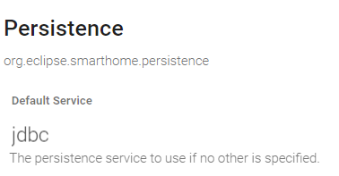

jdbc is set as default in conf/services/runtime.cfg & in the paper UI. I already restarted OpenHAB
################ PERSISTENCE ####################
#  The persistence service to use if no other is specified.
org.eclipse.smarthome.persistence:default=jdbc
