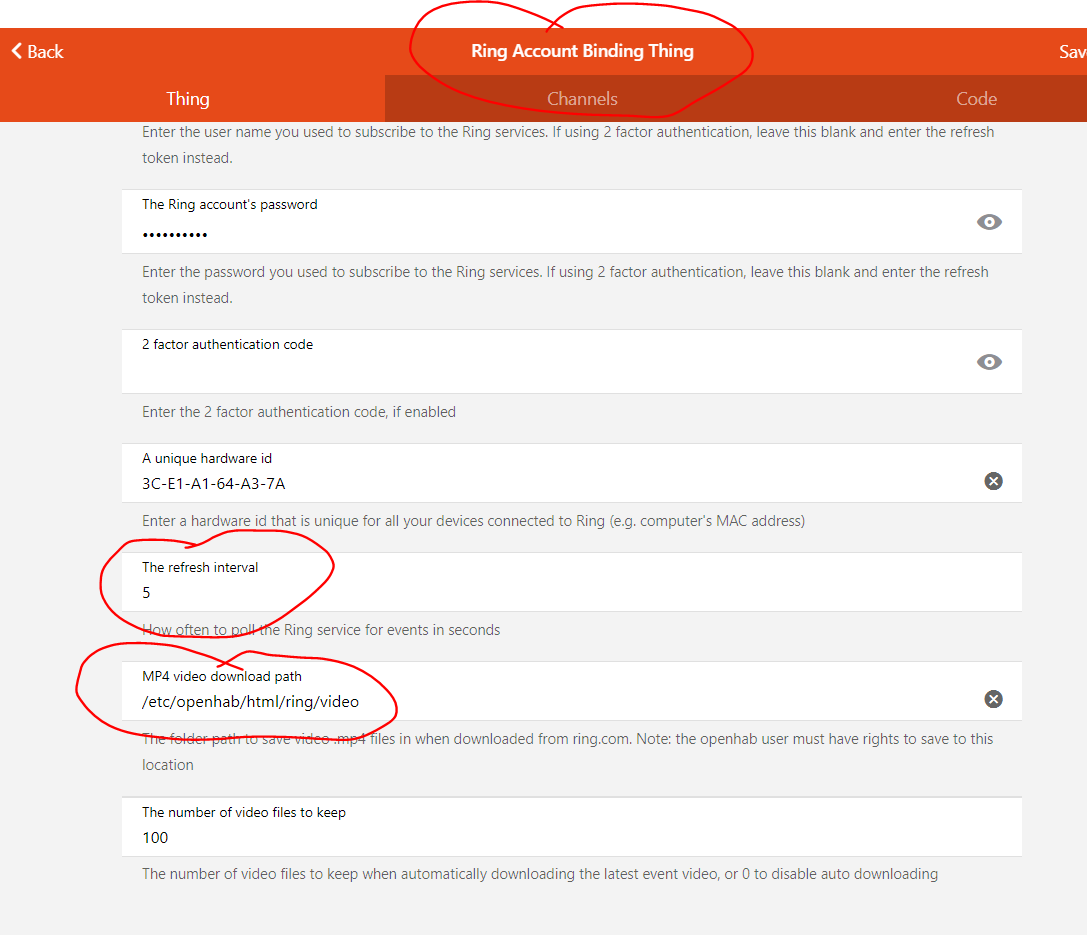

Jay, thanks for offering help! Well, I’m a nerd but I’m completely unexperienced with Ring devices.
I managed to
  • install the binding
  • added a Ring account thing
  • added a Ring Video Doorbell thing

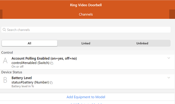

Latter provides just two channels, see screenshot.
What am I missing? Ideally I would see a trigger channel if something moves in front of the doorbell, another channel if someone rings the bell and maybe a picture/video stream URL?
PS: I noticed an error message in the log complaining about the path /etc/openhab2/html/ring/video
Once created with correct permissions, I could see a few video files
best regards, Stefan

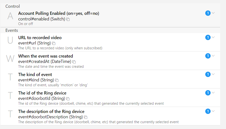

The stuff your looking for is in the account area, not in the doorbell area.
Here’s my rule for the ring doorbell, there is a 2 minute delay for OH to see the changes from the RING API. My rule integrates the IP Camera binding also to capture a image. This rule is actually tied to 2 different doorbells in two different locations.

Good morning everyone,
I got the binding running yesterday but have one issue:
The timestamp of the last event doesn’t get updated.
The Account thing has an polling update of 5 seconds and is shown as “online”.
I created a normal time point item over the openhab UI.
When relinking the item, it gets the latest timestamp, so that information seems to be in place…
Any idea what might cause that issue?
Thanks a lot,
Christian

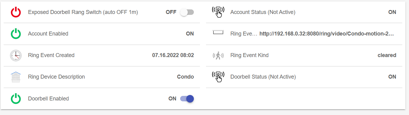

I have confirmed mine is working.
Ring Event Created 10.22.2022 16:05
Here’s my item definition of it.
DateTime   RingEventCreated               "Ring Event Created [%1$tm.%1$td.%1$tY %1$tH:%1$tM]"              										{ channel="ring:account:7494353203:event#createdAt" }
Best, Jay

If I got @jwiseman correctly, there is option to capture a current picture via the ring, correct?
Another question would be, if there is an option to trigger the mode selection “Home”, “Away” or “Inactive”? I do not rely on the “Geofence” function of ring - hence I would like to pair it with my presence rules in OH3. Any ideas?
Final question: What exactly does the “account polling” channel tell me on account or respectively on doorbell level?

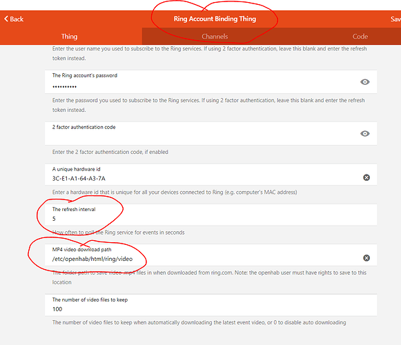

I have the same issue. I was successfully able to install the Binding today. But my created Items from the Things are not updating except from the initial discovery, so when the Doorbell is rung, OpenHAB does not detect the state change, so I can’t get any Rules to fire.
Did you ever manage to resolve this?
Thanks,
Lee
Maybe some progress. The Logs were complaining about an OH2 directory not being present (I’m on OH3) so I manually created the following:
A “ding” is now detected, but as previously mentioned by others, there is an almost 2 minute delay before the Item is updated, which makes it too slow to use in real-time.
Any workaround to this?
