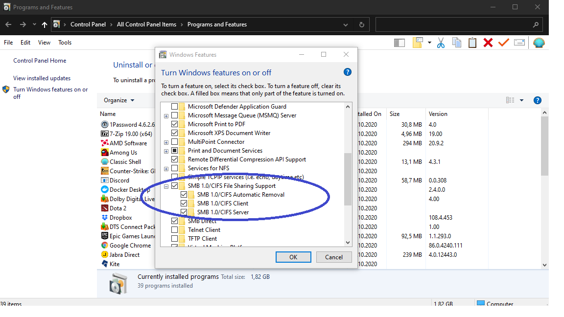

I used the latest OpenHABian install and tried to access the Samba shares as described in the quick start guide. After Windows 10 computer refused to connect even with different paths provided by the guide, I started to look for solutions. To make it work I had to:
  1. Enable the SMB 1.0 Windows Feature under Control Panel->Programs and Features-> Turn Windows Features on or off.
  2. Enable insecure guest logons under Local Group Policy Editor Computer configuration\administrative templates\network\Lanman Workstation
For me that was it, there were no need for changes on the smb.conf file on Linux.

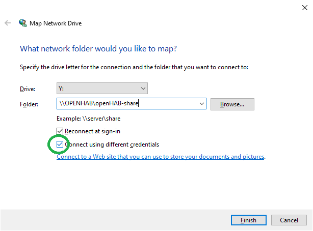

  1. While you will map the network drive (“\IP of your OpenHab2server\openHAB-share” or just “\OPENHAB\openHAB-share”) to your Windows PC check “Connect using different credentials” and provide your user and password. Default username is “openhabian” and password is “openhabian” :slight_smile: Do not forget to be secure!
Under this folder you will find all folders which you need to start with OpenHab. (Logs, config, user data etc.)

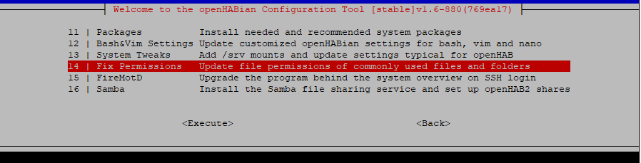

Did you apply for Fix Permissions in openHABian configuration tool?
Install Putty
connect to your OpenHabian server with your IP address or Hostname.
User: openhabian
Password: openhabian
write:
sudo openhabian-config
Go to 10 Apply improvements
Fix Permissions and that should do all magic.
Let me please know if it worked. I would like to have super precise guide to follow.
I did this already before a couple of times but with no success.
