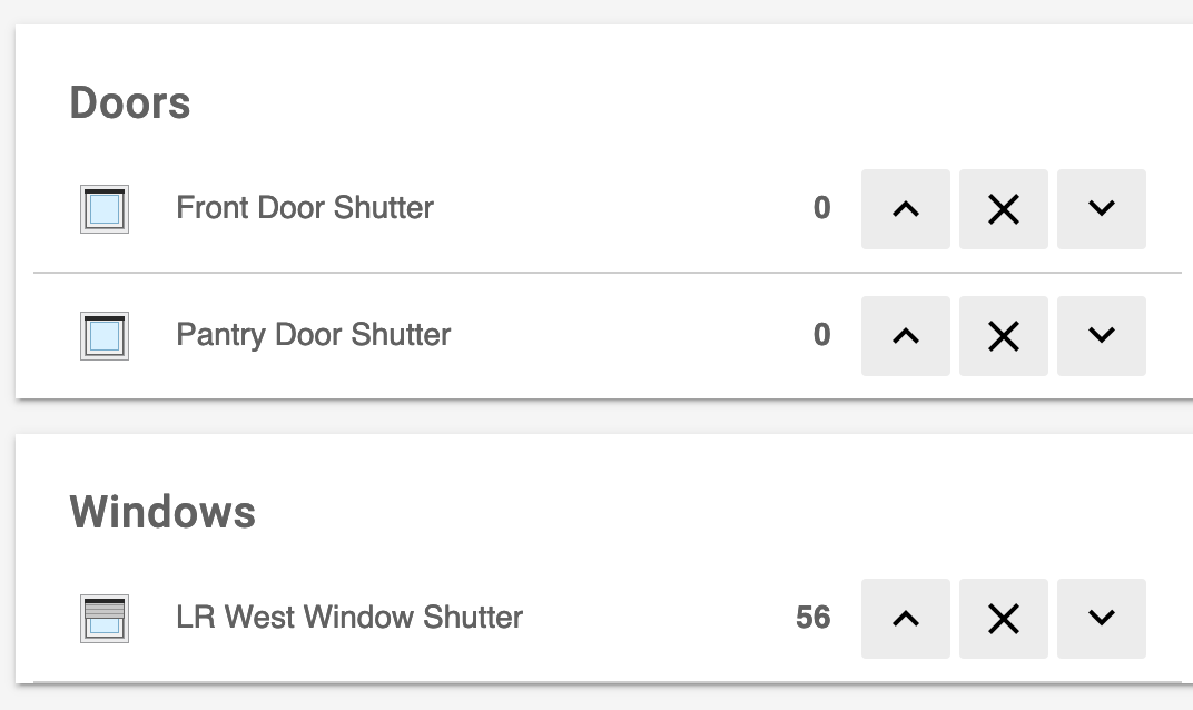

The first clue is that the suspect shutter is at “position:56”
The second clue is that there are times when the position is “-” (basicUI) when all other shutters show a numeric value (usually 0).

BasicUI screen shot

When using a switch item for a rollershutter on BasicUI…there is the up / down arrow buttons as well as the center stop button. To the left of those 3 buttons is a numeric value (a dash if no value is available).
Do you know how that number (shutter position) is populated on this widget? The value is available from the SONOFF message shown below…

The BasicUI is shown next. Notice that the two rollershutter switches fail to show a value for shutter position (0-100), but rather a dash mark.
And finally, from the console, you can see that the LRw shutter has a position of 56, LRe has a position of 0, yet they do not display.
