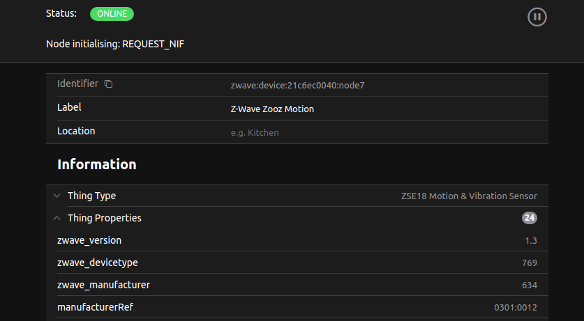

The DSK method is not supported in the OH binding. AFAIK it is only used with S2 anyway. IIRC on the UI properties dropdown it should say secure inclusion if it worked. Also could tell from debug logs to see if Nonce is being used.

Where is the UI dropdown?
IIRC = ‘if I remember correctly’
see below ‘Thing Properties’ with little chevron next to it
