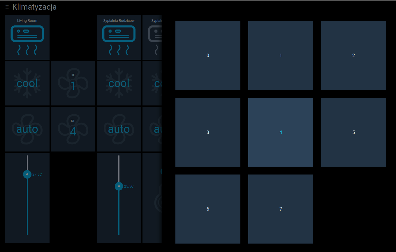

I’m looking for a good way of showing air conditioning functions in a simple way. I’m working on a binging and for now I prefer to focus on the binding development instead of making a shiny widget. But I want to be able to use the channels that I already coded in the binding and for wind horizontal and vertical wind direction I I have numbers:
I’m looking for a way to replace the numbers with icons representing the wind direction. I have the icons, The Selection widget allows to use text instead of server provided options.

Be careful here. The screenshots you have shown are HABpanel but the two widget pages you have linked to are MainUI widgets; these are not compatible.
If you are really asking about MainUI widgets then there are many good options.
It’s been so long since I’ve used HABpanel that I can’t really give much advice there.
