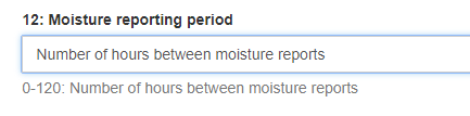

I purchased one Sensative Z-wave comfort strip and beside it not reporting anything to openhab (i will still be patient and try to make it work) I cannot set its Moisture reporting period to any value, select box contains label instead of values:
Instead of the text inside dropdown, choice from 0-120 should be presented.
There were several errors in the database. I think I fixed them so after the changes are merged into the binding you need to upgrade to the latest snapshot or development version.
