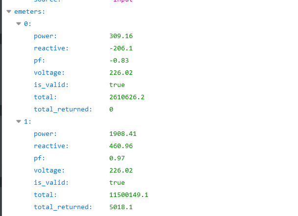

Hi Markus
A couple of months ago you did some fixes for the Shelly EM to “calculate” the PF as it was not available in the /status. This has been fixed in the latest firmware
If the PF is now available from the /status which value will be used? The calculated value or the published value?
Mark
