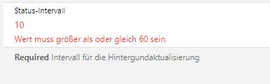

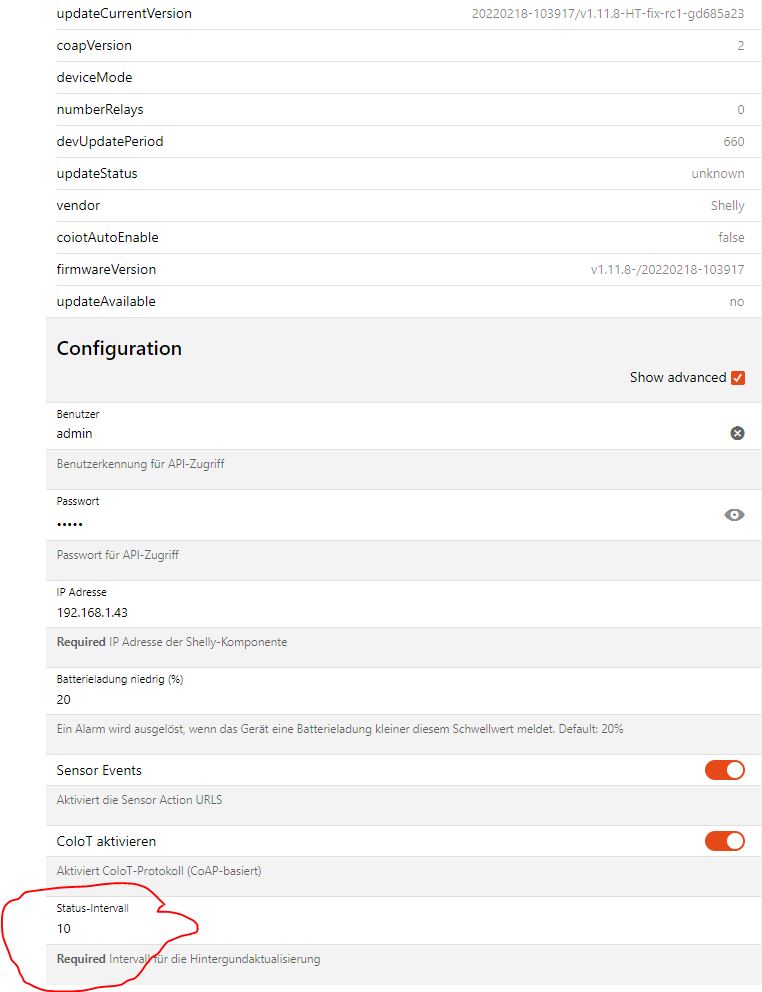

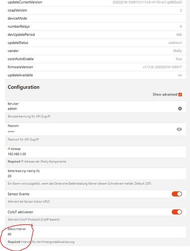

I have some issue with a HT which was added to OH3.2.0
The settings value “status interval” seem to be set to min. 60 sec.
In past I was able to set it to 10 or less sec as min. sample rate.

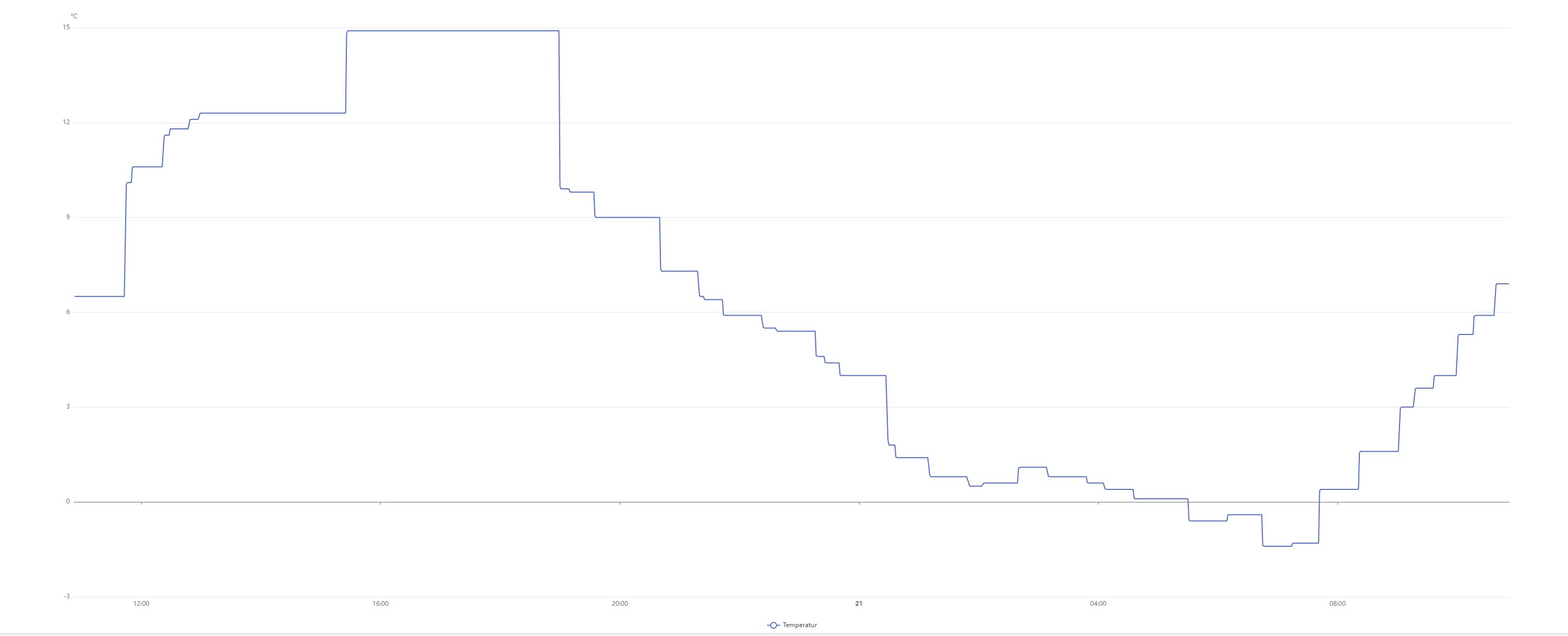

Pricipale it works, but the sample rate is to low some how, that OH 3.2 will not more get all values, every 10 min, when the HT sends the value. The HT is connected via USB to the power.
Here are some examples.

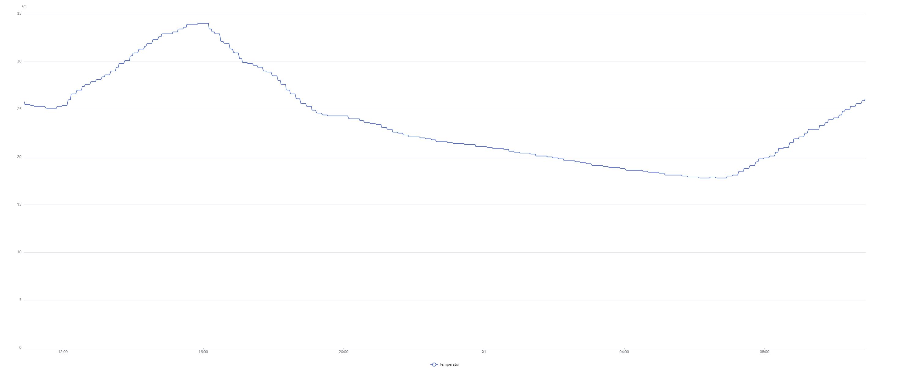

From the curve you can see that the sample rate is much lower compared to other HT’s…
Here are some examples:
It doesn’t make sense to change interval for H&T polling (or in general for all battery powered devices). There is no way to actively wake-up the device while in sleep mode. Allterco implemented some logic to optimized battery lifetime.
You need to have a clean setup of CoIoT notifications. Make sure that CoIoT is enabled you your OH IP is specified as peer address in the device settings. You could use Shelly Manager (oh ip:8080/shelly/manager). Press the H&T button to wake up the device before making changes.
Changes to the measurements will be updated instantly once the device sends them (also depending on selected treshholds).

Thanks for the Feedback.
CoIoT was set before etc. The new HT was an old HT and everything were everywhere were set. beforehand.
I have now rebooted OH and now it seems, that the value come all 10min as before.
Thanks for the tip.

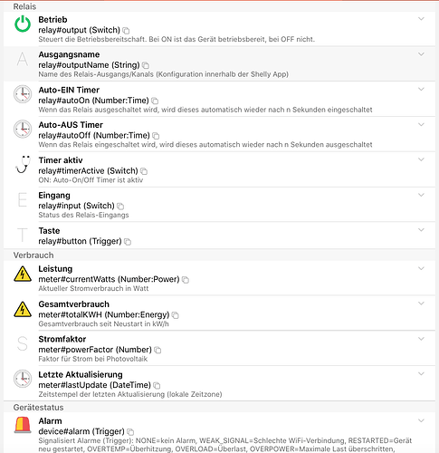

i tried to insert my plugs with file setup into my system… and the thing is green and marked as online bit the items are showing “invalid link”..
the thing (which is online)
Thing shelly:shellyplugs:SPLUG-PC “Server Stecker” [deviceIp=“192.168.63.151”]
And the item
Switch Shelly_Out “Server Outlet”{channel=“shelly:shellyplugs:SPLUG-PC:relay#output”}
Number Shelly_Power "Server Power " {channel=“shelly:shellyplugs:SPLUG-PC:meter#currentWatts”}
Number Shelly_Usage “Server total” {channel=“shelly:shellyplugs:SPLUG-PC:meter#totalKWH”}
So where im wrong ?
Ciao Gerd
Try to add the using the UI first, then compare JSONDB with your definition

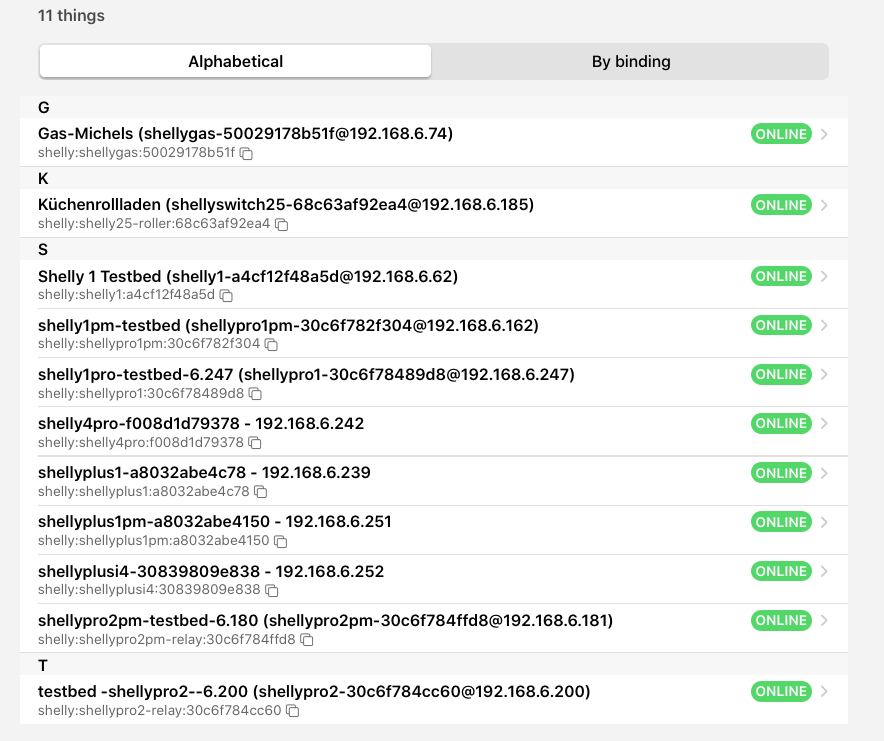

Is there someone who wants to support Plus/Pro testing (it’s in status experimental)?
Very timely. Just invested in a few Shellys. I have a Shelly Plus 1 Relay Switch. If you have the URL for a JAR, I would be happy to install and see what happens.
Thank you for your continued effort on this.

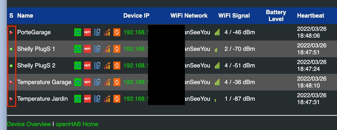

Hello. I am using some Shelly1 and OpenHab3. On the device overview of OH3 I have “red arrows” or “green dots” in front of the devices. What do they mean?
not required if you access shelly devices via CoIoT.
put your mouse over that symbol. In the popup you‘ll see notifications
Hi @markus7017 , I would give it a try. I only have two plus devices but would get a few more in for the sake of development (any excuse to buy more widgets!)
