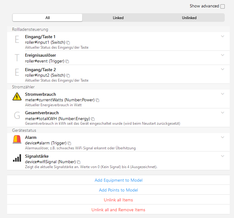

I have once again the problem where the shellies are not initializing properly.
Only after removing and adding the file multiple times the control channel appears.
@markus7017
Would it be possible to always add the “control” channel if the thing is a *-roller thing?
I think it’s safe to assume that such a thing has a control channel to move the shutter.
Thing shelly:shellyplus2pm-roller:AAAAAAAAAAAA "ShellyPlus2PM: Rollladen" @ "Room" [deviceIp="192.168.X.XX"]
Channels after reboot / openhab restart
Channels after removing/adding the file multiple times:
It’s a very annoying bug since 3.3 because I only realize there is an issue when there are shutters which don’t move in the evening.
