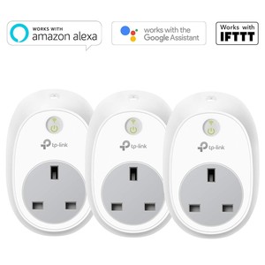

You could always hook an actuator up to a TP-Link HS100 smart socket and control that via openHAB2.
Although they do “Call home” I have simply blocked it’s access via my router.
You could go a stage further and setup an isolated SSID for them, which openHAB2 would need access to.
Good luck
If you do that you could use a Z-Wave or ZigBee smart socket which keeps everything local and off your Wi-Fi.
