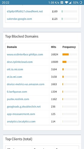

That’s why I’ve blocked my HS100 from the internet.
I can see in the router log that it keeps trying, but that’s not a big deal.
If I had dozens of them, I’d definitely put them on an isolated SSID without internet access.

From Pihole:
Next to the Philips hue, they’re second!
Wow, that’s a lot of call backs
