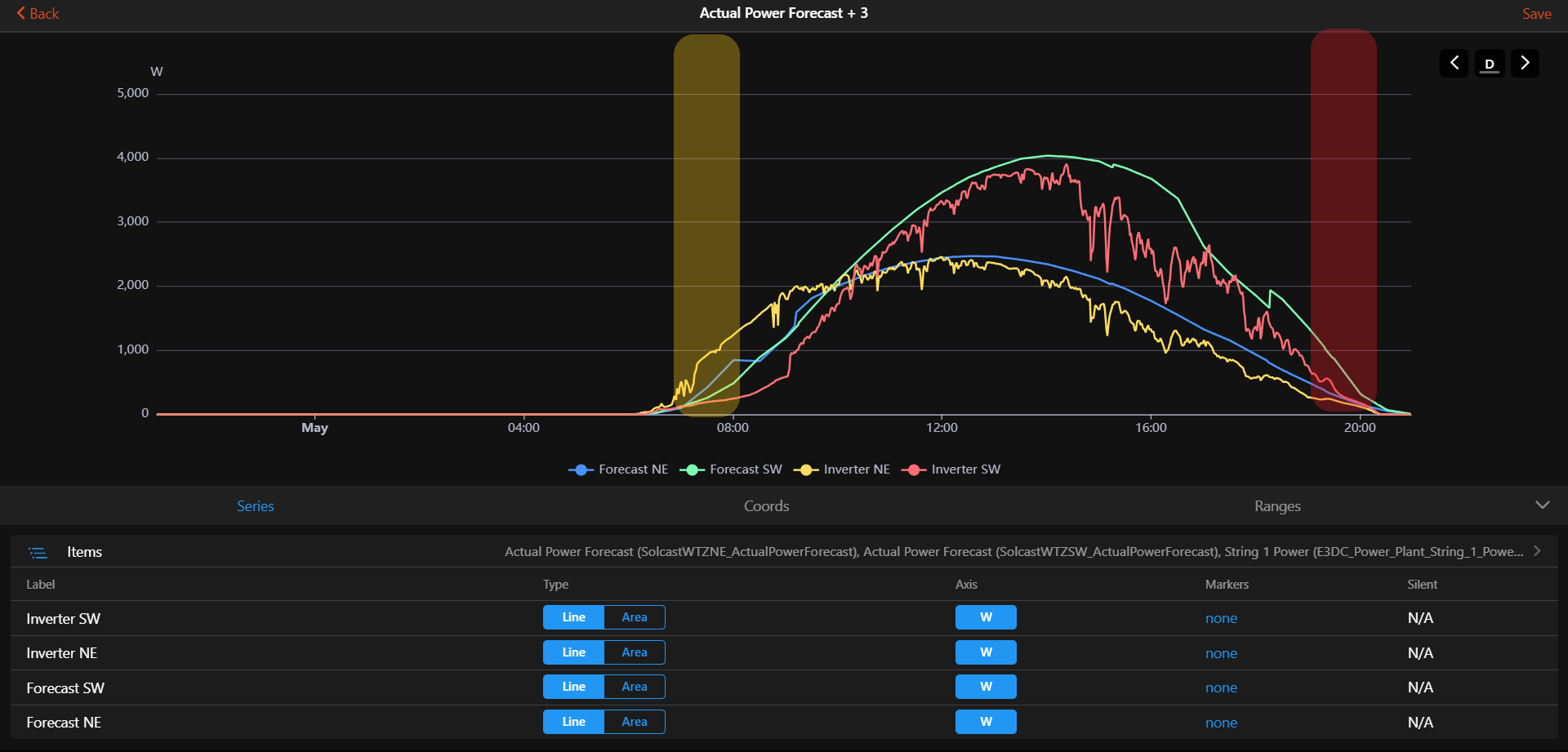

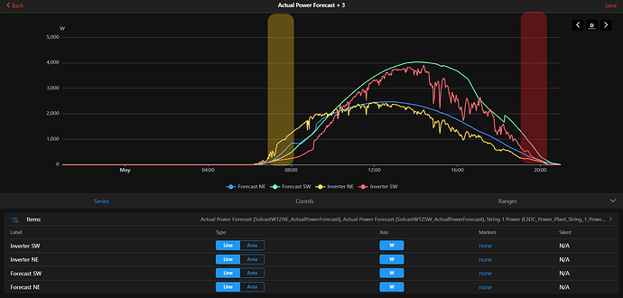

I understand what you say. But I seem to have the case where the binding thinks that my north facing solar plane was getting sun on it, even when the sun was physically below the ridge line of the roof. (note: winter in northern hemisphere)
I see your point. Think I’ve a similar situation, one pv plane facing north-east the other total opposite south-west The picture with comparison NE vs SW is below.
I’ve the luxury to compare the forecast against my inverter measures.
There’s no way in yellow mark in the morning that my SW plane is getting direct sunlight.
But I get the measures from my inverter and it’s producing.
There’s no way in red mark in the late evening that my NE plane is getting direct sunlight.
Again the measures from inverter shows production.
I think this has to do with diffuse sunlight which hits your pv plane rather than direct sunlight. Maybe @Forecast.Solar who owns forecast.solar service and is member of the forum can elaborate on that.

As you can see from picture in previous post pretty much aligns with the forecast. If it doesn’t you’ve the possibility to tweak your forecast with advanced parameters like
  • damp factor
  • horizon
If it still doesn’t match the bindings will not do any corrections on the data provided by Solcast or forecast.solar

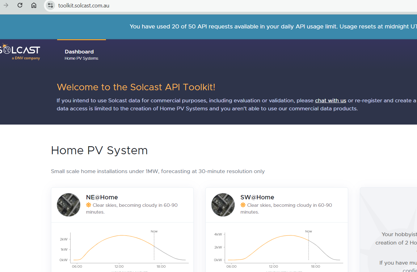

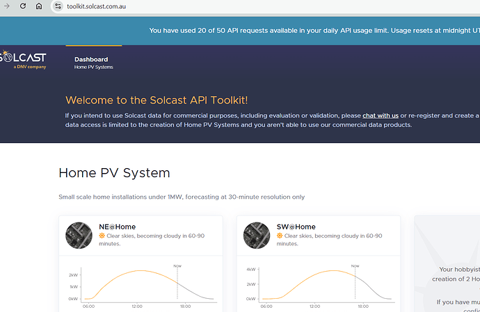

This error indicates, that the rate limit has been reached for my current subscription level (I’m using the free hobbyist plan).
I’ve double checked the sc-plane settings and the ā€œForecast Refresh Intervalā€ is set to 120 (minutes).
After double checked, it looks like Solcast changed the hobbyist plan to a limit of 10 API calls per day. Now I’ve changed my refresh rate to 150 minutes to stay below this limit to see if the error will not longer occur.

Correct investigation, error 429 indicates throttling limit is reached. Double check this with logging in into your Solcast account. On the top you should see
  • how many calls are placed today
  • how many calls you have in total available
If you have the total calls available you’re able to caclculate your update rate.
Note that each time you stop/start things or bridges or you update configuration will result into destroying the objects and new initial calls are placed. So if the config is running - keep it running!
Thanks, great hint! I didn’t know about this indication on top of the page until now.
It looks like the free API is now limited to just 10 calls per day.
With just one plane I think I will stick with 5h (300 minutes) interval for my situation. This will also gives room for at lease one restart/reload scenario.
