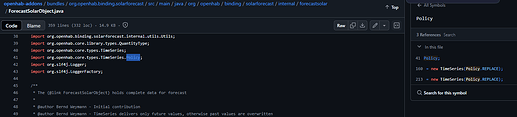

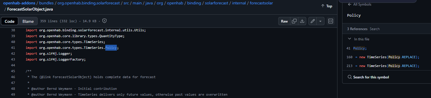

@weymann - would changing the policy to ADD here help to bridge API outages, keeping the data fetched already?
No, this will cause multiple values for each timestamp in normal cases which is the majority of the updates.
