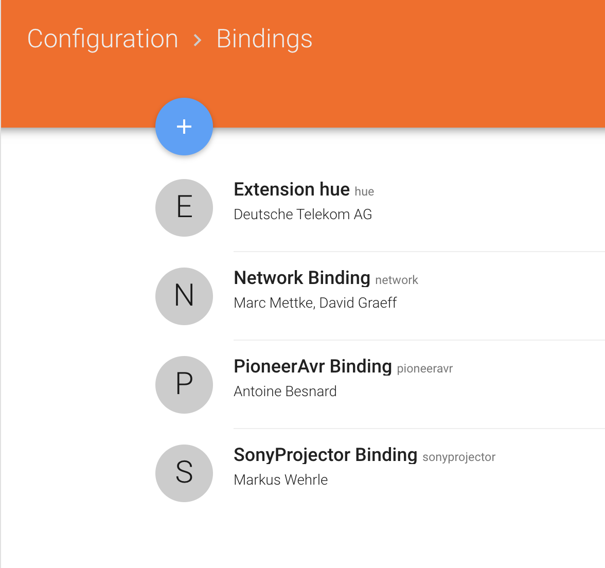

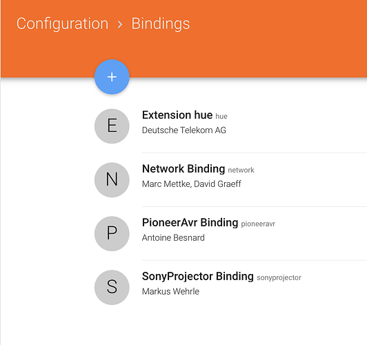

After installing the binding, in PaperUI > Configuration > Bindings it doesn’t show the binding?
Have you checked via the console to see if it’s listed and active?
Nope, it’s not listed.
But as it’s file based configuration, I would have imagined that it requires a full setup to work.

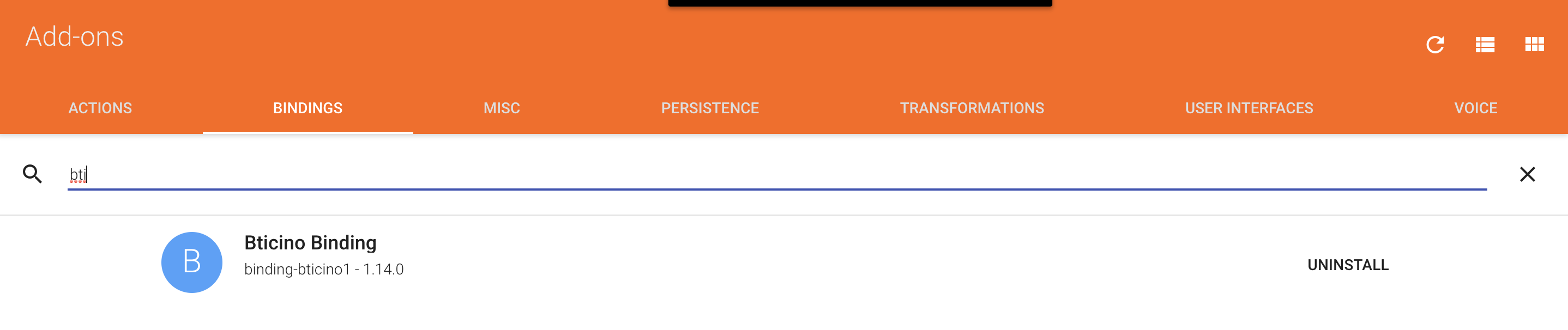

In the binding, it’s marked as installed :

218 │ Active │  80 │ 1.14.0                  │ openHAB BTicino
That binding is a version 1 … is there a newer version out?
Well, I only see this version when I’m looking for bticino in the bindings section
Just checked and looks like there is no version 2 binding.
