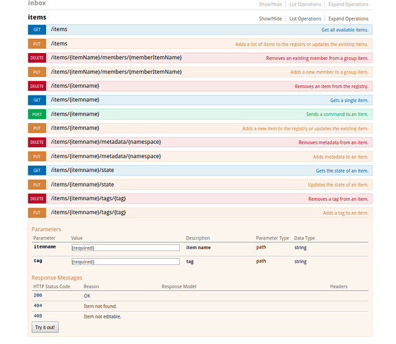

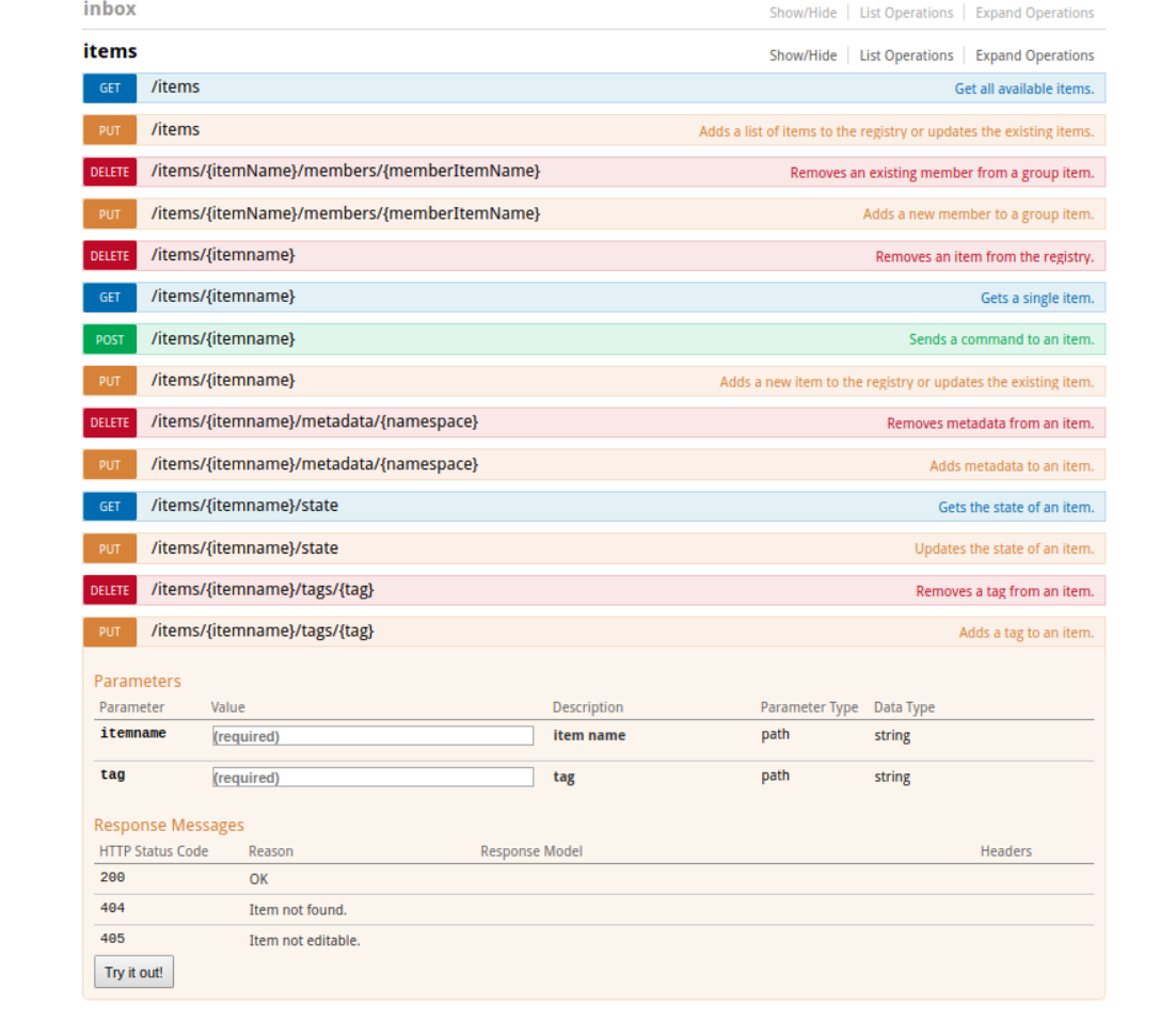

You can use the rest API to add tags to items:

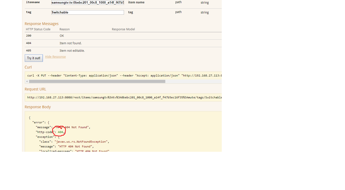

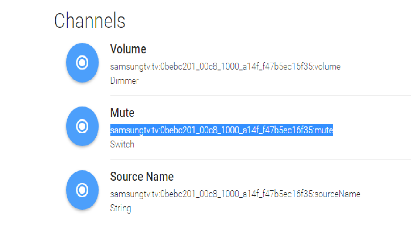

Where do I get the item name from? Paper UI? If I do that, I get 404 item not found

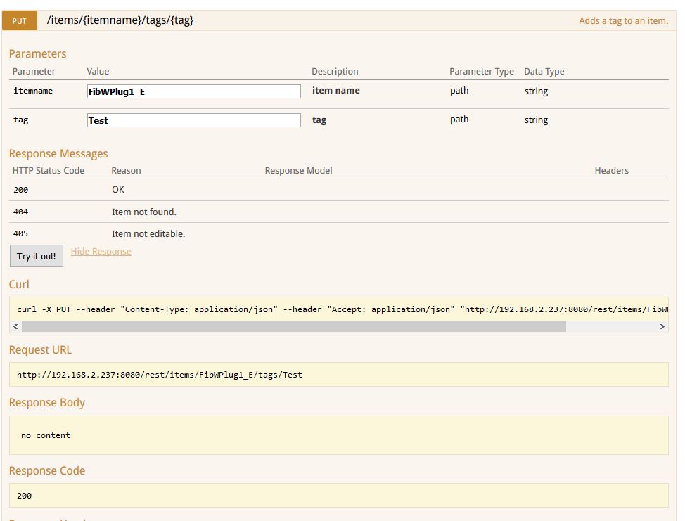

That should be the way to go. Just tested and I get 200 OK:
I am still getting the same error, device is powered up and I can control it with paper ui successfully
You are using the channel name .. take the item name.
As in ‘volume’ or ‘[TV]Samsung LED32’?
Not “As in”, but your itemname :grinning:

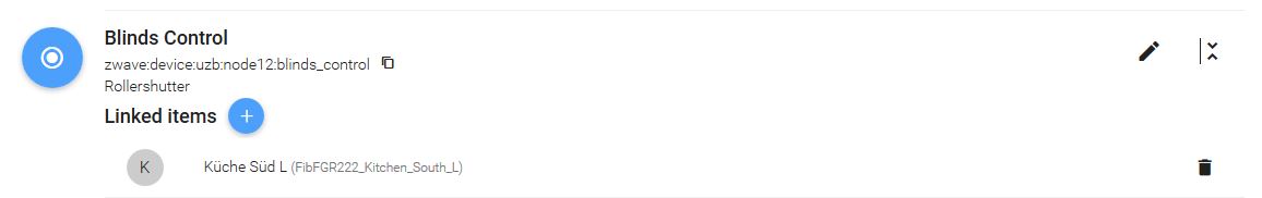

Look those up in PaperUI, in that screenshot
zwave:device… is the channel definition
Rollershutter is the itemtype
Küche Süd L is the label of the linked item
FibFGR222… is the item name (which you need to use to set tags via REST)
So looking at previous screenshot: ‘Dimmer’ ‘Switch’ ‘String’ then?

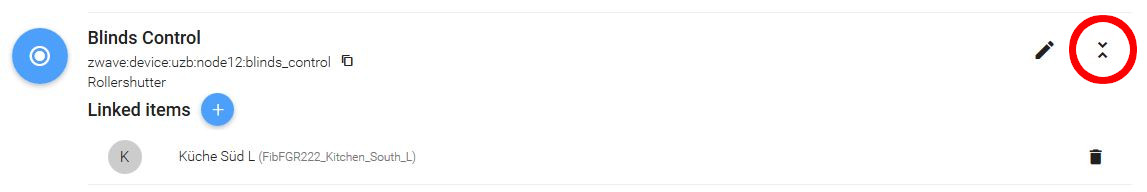

Edit: How do you get the ‘Linked items’ thing to come up from the bottom?

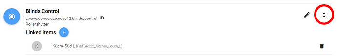

As you have linked items to channels which I can see from your screenshot your question may be targeted to something else:
Click on the button with the up/down arrows to see
Thank You very much, I managed to make this work in the end but only by looking at ‘linked items’ in restapi and then copying the id. Thanks for helping me and giving me a great first impression on this forum. I am closing the resquest, Thanks!
