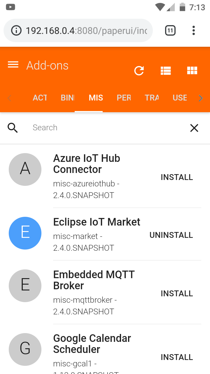

I trying to Install the market integration, I have…

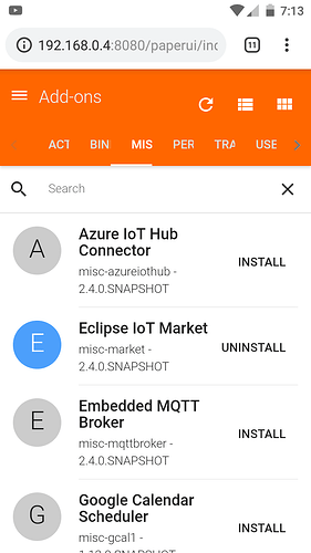

Add-ons → Misc → Eclipse IoT Market.

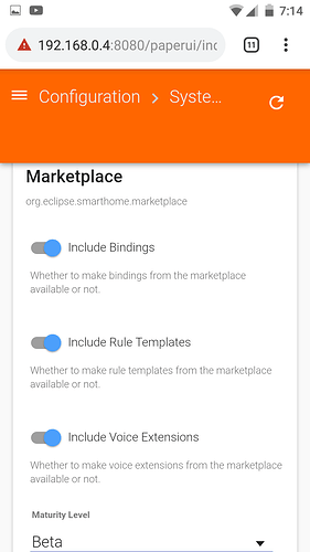

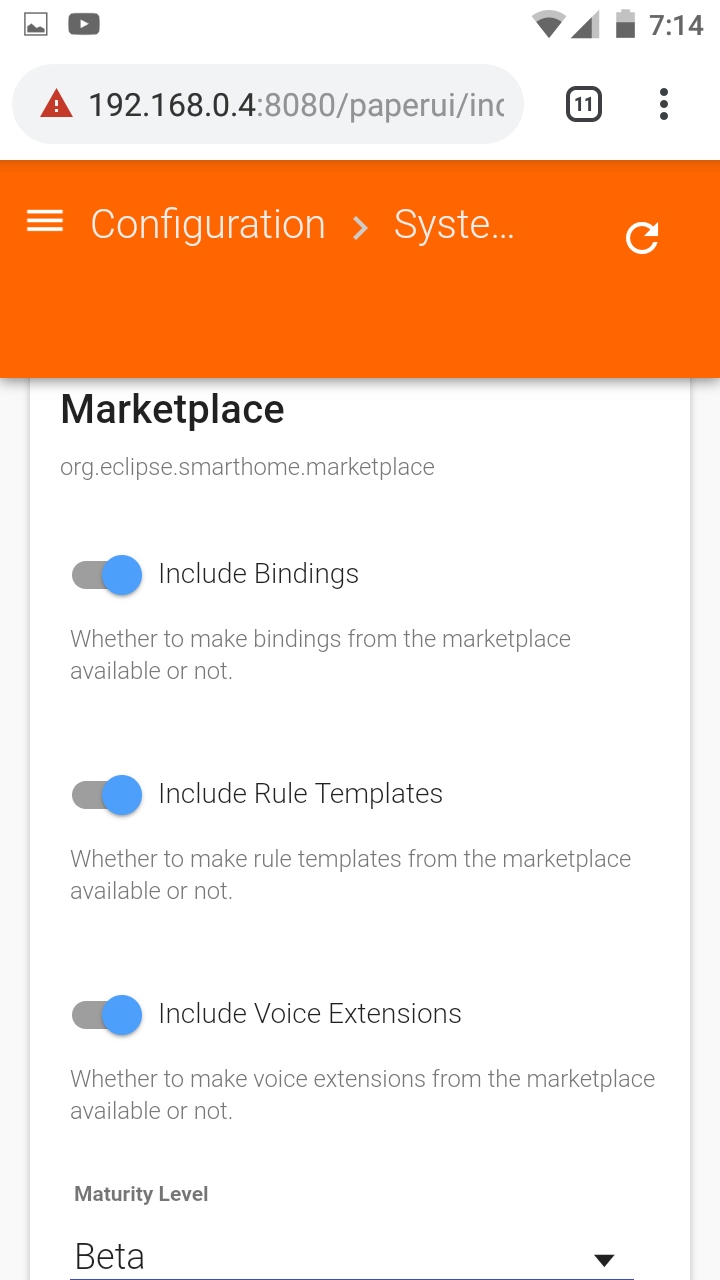

and
Paper UI under Configuration → System → Marketplace
said yes to all
But I can not see the third-party add-ons in Bindings
Can anyone els see them in openhab2.4?

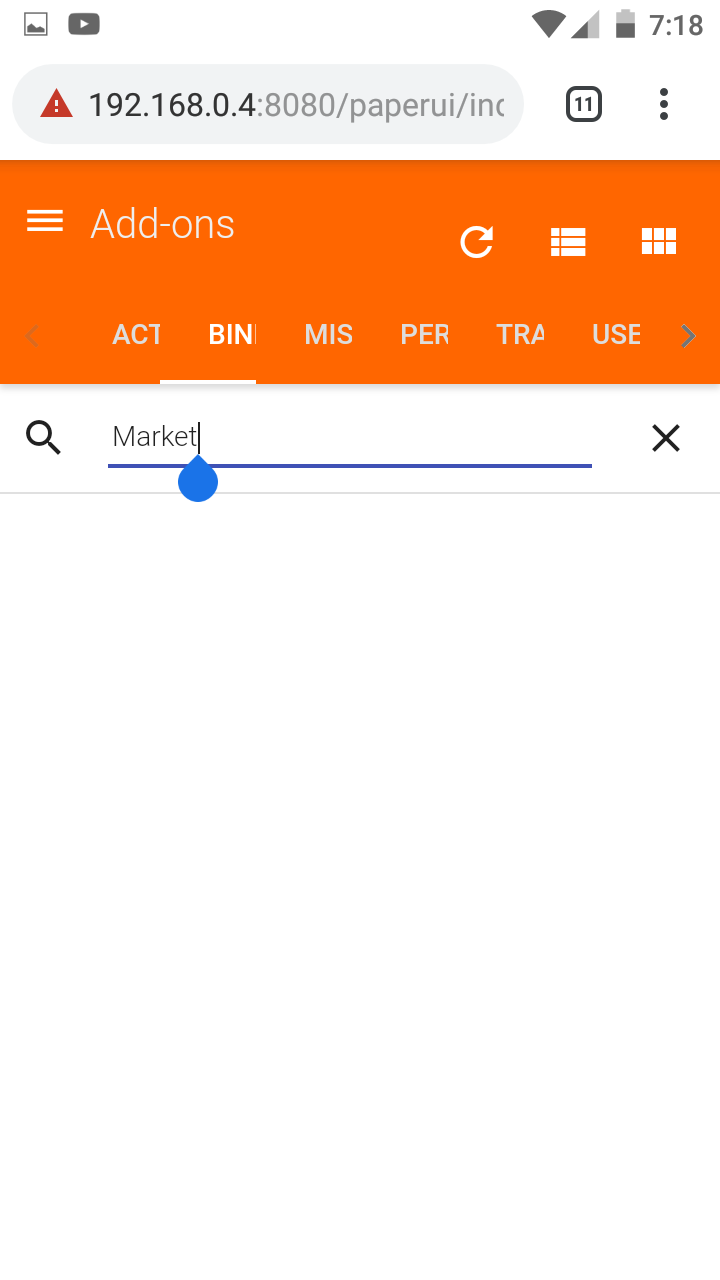

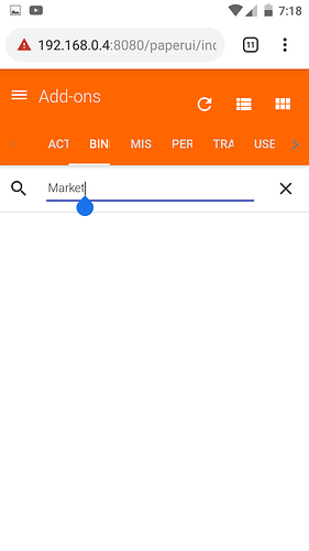

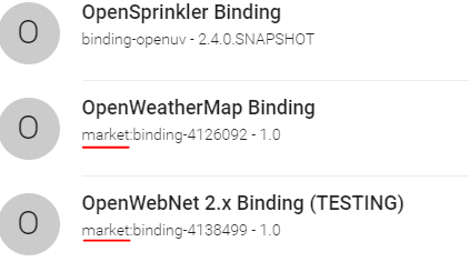

They are not listed separately. They are just added to the list under bindings, actions, etc. The way to tell whether you are looking at an official binding or a marketplace binding is the ID.
Instead of searching just scroll through the list. Are there ANY bindings with “market” in the ID (small text under the binding name)?
no I don’t
