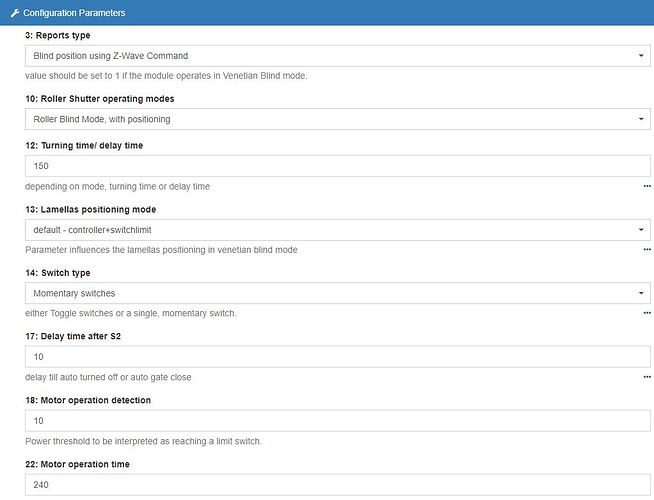

Hi, I have several Fibaro Rolleshutter 222 controlling all my blinds in openhab2 (last stable version), and they work fine when I try to control them from the android app, via rules or web interface. But if I switch them using the 3-position manual toggle, despite the blinds moving as expected, there isn’t any updates in openhab until the next polling cycle (in my case, every 30 min).
In Habmin, I’ve set the param 14 so they work with toggle switches (and they do), and I’ve tried setting param 3 as Fibar command and Z-Wave command. No difference at all.
I’ve set the association groups (“openHAB controller” in all groups), and when I check the logs I can see that every manual change triggers this warning for each rollershutter node:

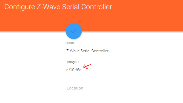

You can change the Thing ID to match your old serial controller’s ID and all your recreated Things will retain the same ID as the old ones.
I can’t help much with the specific problems but wanted to make sure future readers see this and maybe avoid the same mistake.

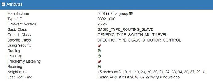

Are you able to share your configuration and version of FGR-222?

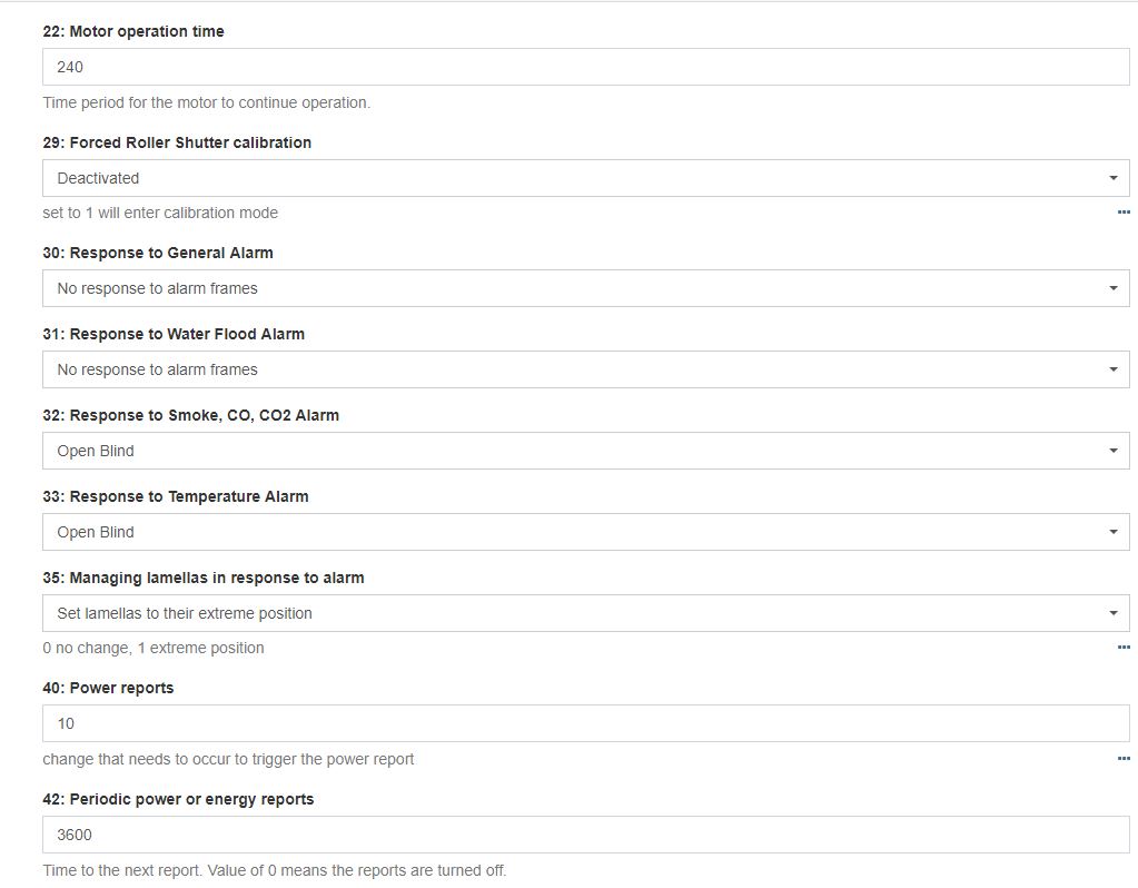

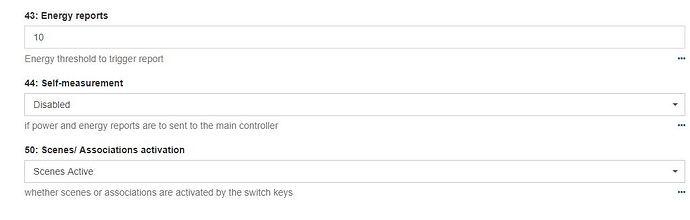

One out of six:
Please note that I don’t use the lamella function. If the problem is related to that, I can’t help because I can’t test :sunglasses:

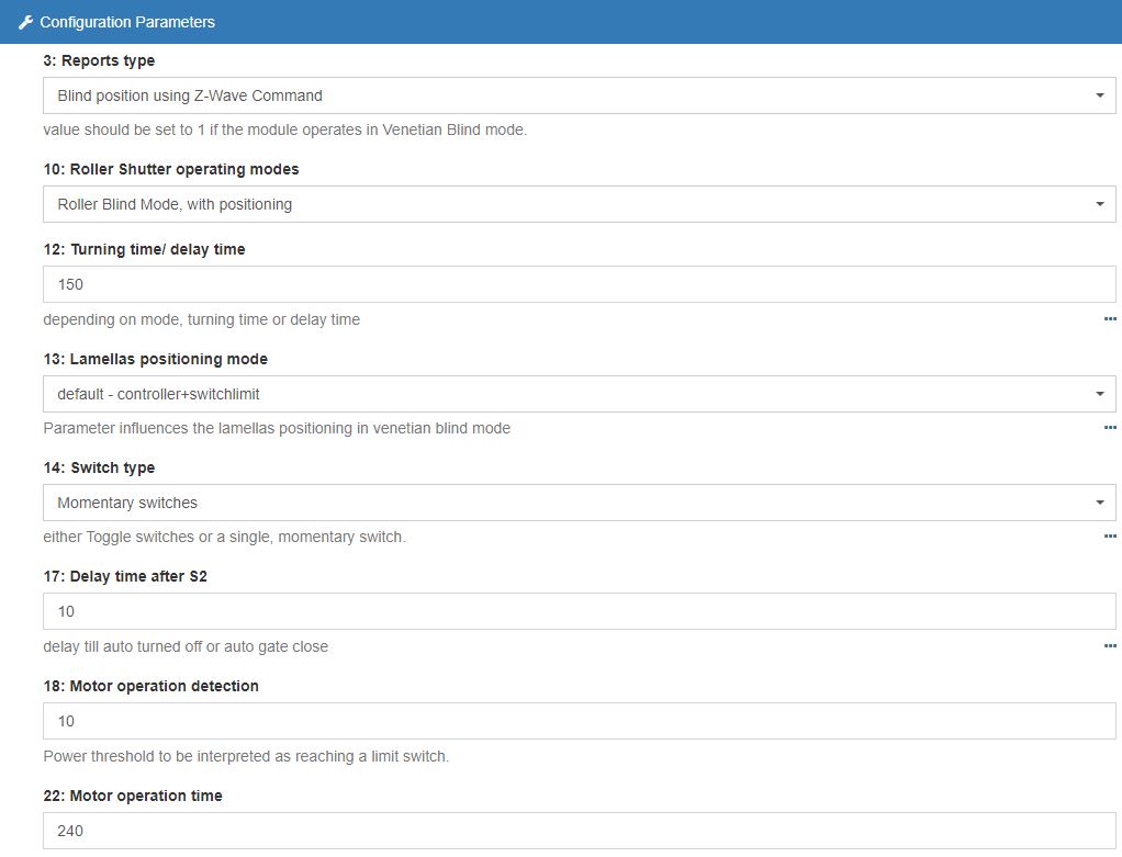

It seems I’m having the same problem as @Chri46. About @sihui config, I have different values for parameter 14 (toggle switch) and 50 (associations instead of scenes).
@sihui, when you say that it always has been working, you mean for every version of the binding in the past?
Yes. I bought those almost two years ago and they always have been working fine.
But as noted above: I have never used the lamella function!

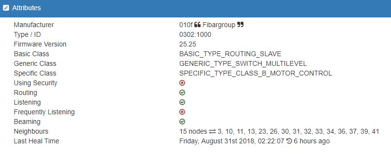

I’m not using the lamella function either. It could be related to your Fibaros containing a different firmware version than ours despite being the same FGR 222 product. I bought mine about 6 months ago, so it would make sense…
If your firmware is different than 25.25. and has different functions/parameters we need to add that to the database.
Please compare your xml file against mine and try to find the differences:
