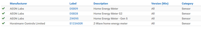

There are several in the database, you need to tell us which one or we can’t help:
grafik
Hi @sihui,
the energy meter in question is the same on the topic: “ZW095 home energy meter Gen 5”

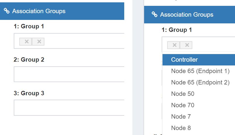

No. Make sure you have parameter 101 set correctly and you have association group 1 pointing to your controller (use HABmin to do that).
I have set parameter 101 to 15
immagine
I have already set up the association Groups of group 1 to controller
immagine
