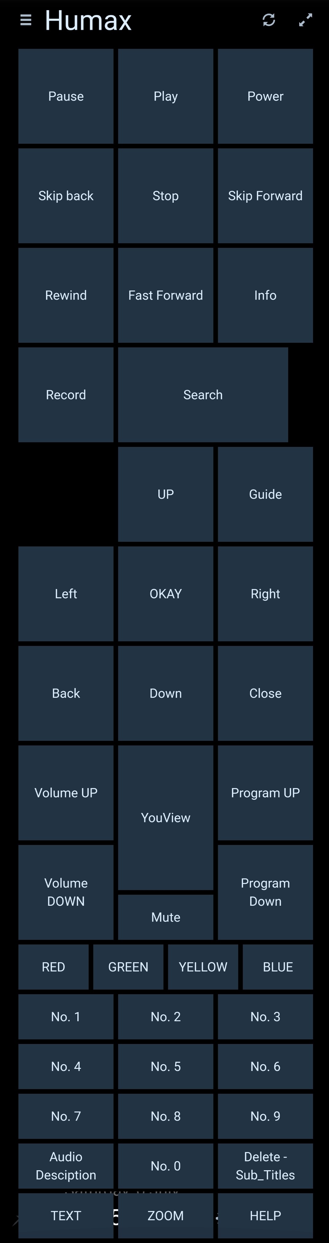

For example, here are the codes for a Humax PVR.

The Items file contains nothing more than this
String UDP_IR_Blaster   "UDP Blaster"     { udp=">[*:192.168.178.240:65432:]" }
String Incoming_UDP     "Imcoming UDP[%s]"              { udp="<[*:65432:'REGEX((.*))']" }
