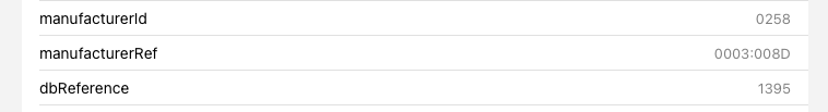

Under thing properties this information would be helpful to see what device it is
Thing properties
Hi Bob, thanks for jumping on this.
As you suspected, the XML does NOT exist for Node 23, and there are only 4 lines at the bottom of the UI page (missing “Reinitialize the device”). I tried waking it up a number of times, to no avail. It does not seem to want to get fully configured. Attached is the manufactureid reference information:
