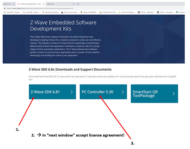

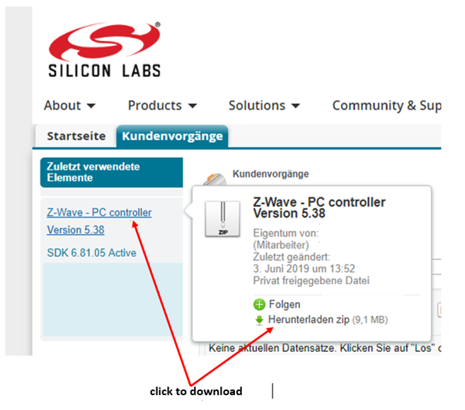

For all who have a Silabs account and like complicated things, follow these steps:
Login to Silabs. Then click on this link.
Or click through: Silabs » Products » Development Tools » Software » Z-Wave » Embedded SDK
  1. Download “Z-wave SDK 6.81”
  2. Accept license agreement in next window
  3. after download (step 1.) → download “PC Controller 5.30”
  4. once you’ve downloaded it you will get a “shared link” to “PC Controller 5.38”
5. maybe you have to wait a little while until “SDK 6.81.05 Active” is shown

While 5.38 is the current version it can also be downloaded here

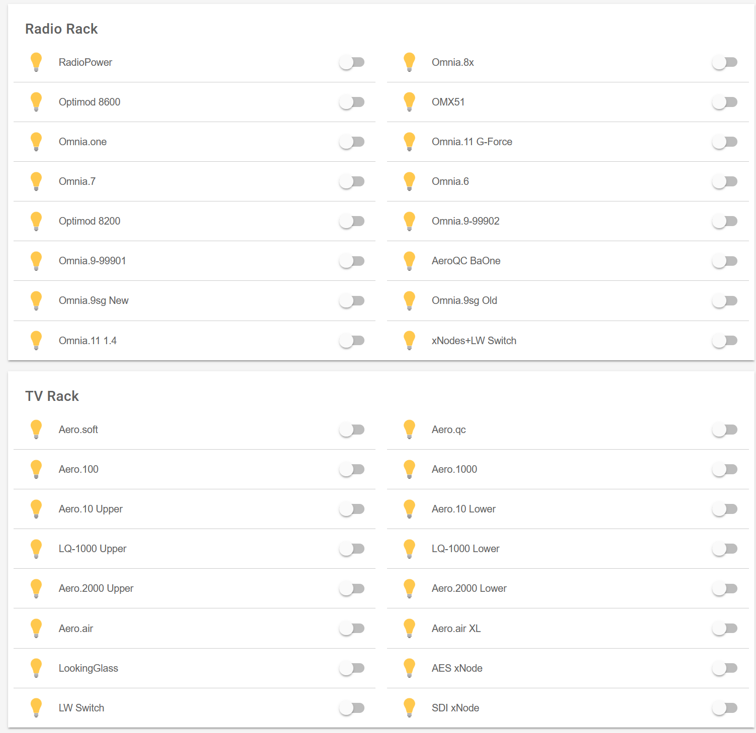

Haha, that’s really amazing :slight_smile: Even an 8200 in there. All sockets controlled by Z-Wave? Any plans for an Omnia 11 or BreakAway One binding in openHAB? :slight_smile:
Just installed it, setup a new ZStick and paired a Aeotec device. All instant! This tool will be very handy. I assume I can just take my production zstick that is causing some grief and try and switch nodes on/off with it that are part of the network.
Actually not Z-Wave! I did buy a large amount (50 or so) Neo CoolCam Z-Wave plugs that I planned to use for this.. and then I realized the wiring would be a mess, plus I was still on Fibaro so the UI would have been a mess too. So, instead I did it with web relays! Four 8-channel web relays (of the ZMWEB variety) each in its own custom enclosure with eight 220v power jacks. I was looking for photos from when I built them (or rather, when my housekeeper’s daughter built them, after I built a prototype and then taught her to solder!) but for some reason couldn’t find the pictures.
All my NF-based things (BreakawayOne, Omnia.9) can already easily be controlled from openHAB by HTTP requests :). Not much to gain from a binding, i think?

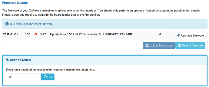

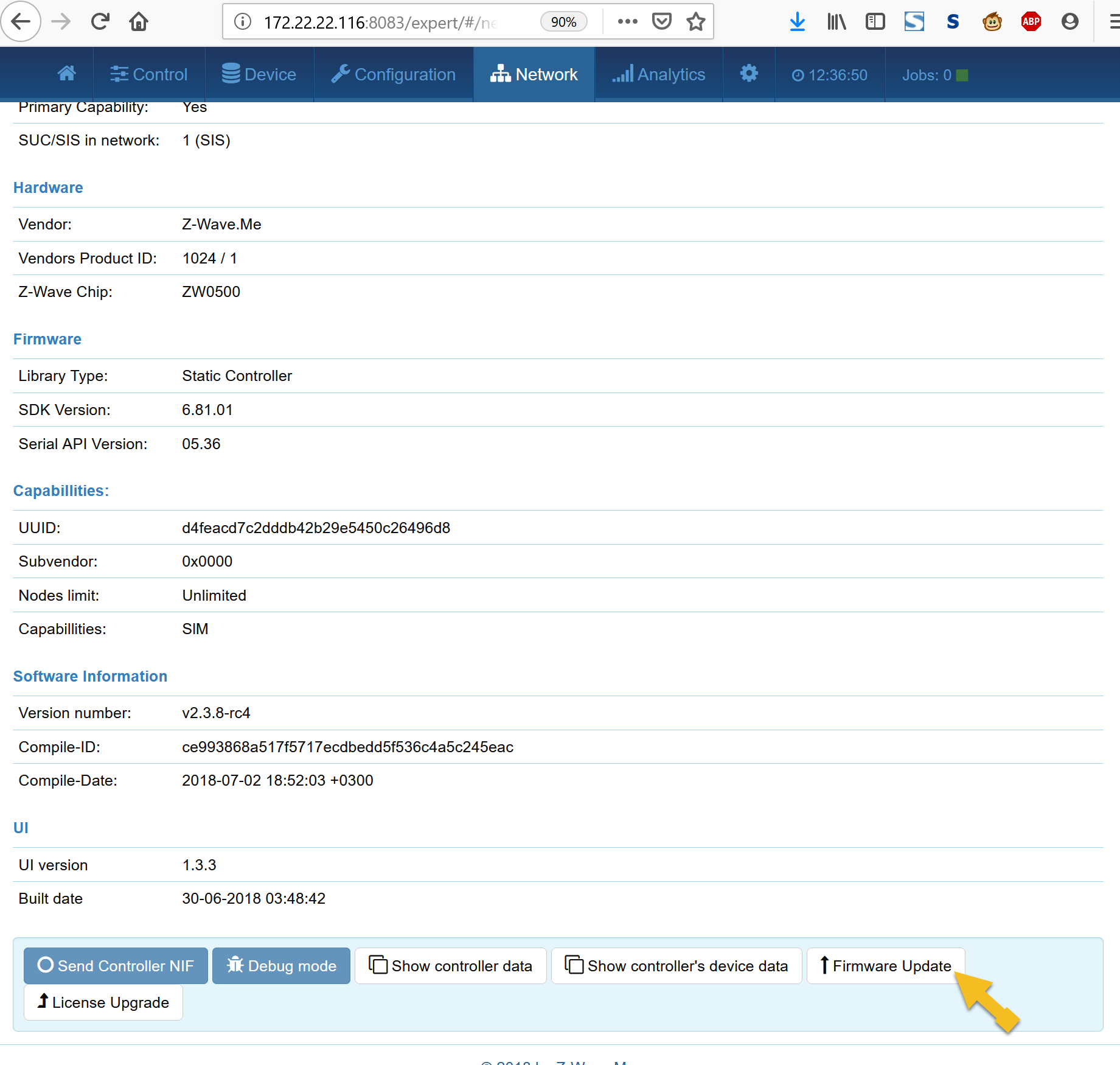

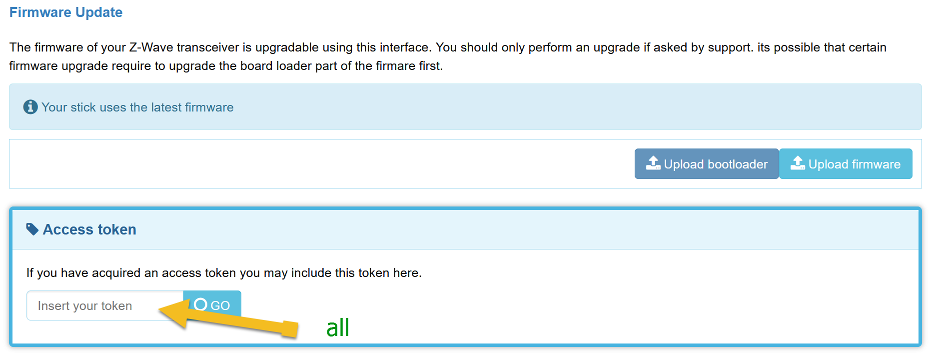

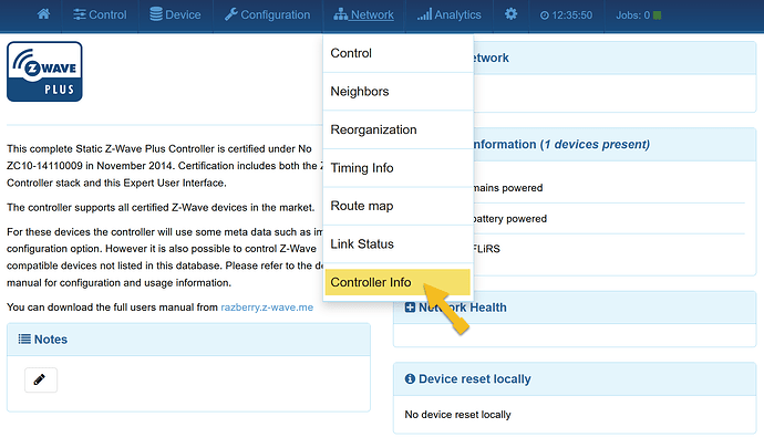

Here, I put together my Z-Way RPi system again and got the screenshots you were looking for.
I’m not downgrading my stick for you :). But the version I’m running, the latest to my knowledge, is 5.36.

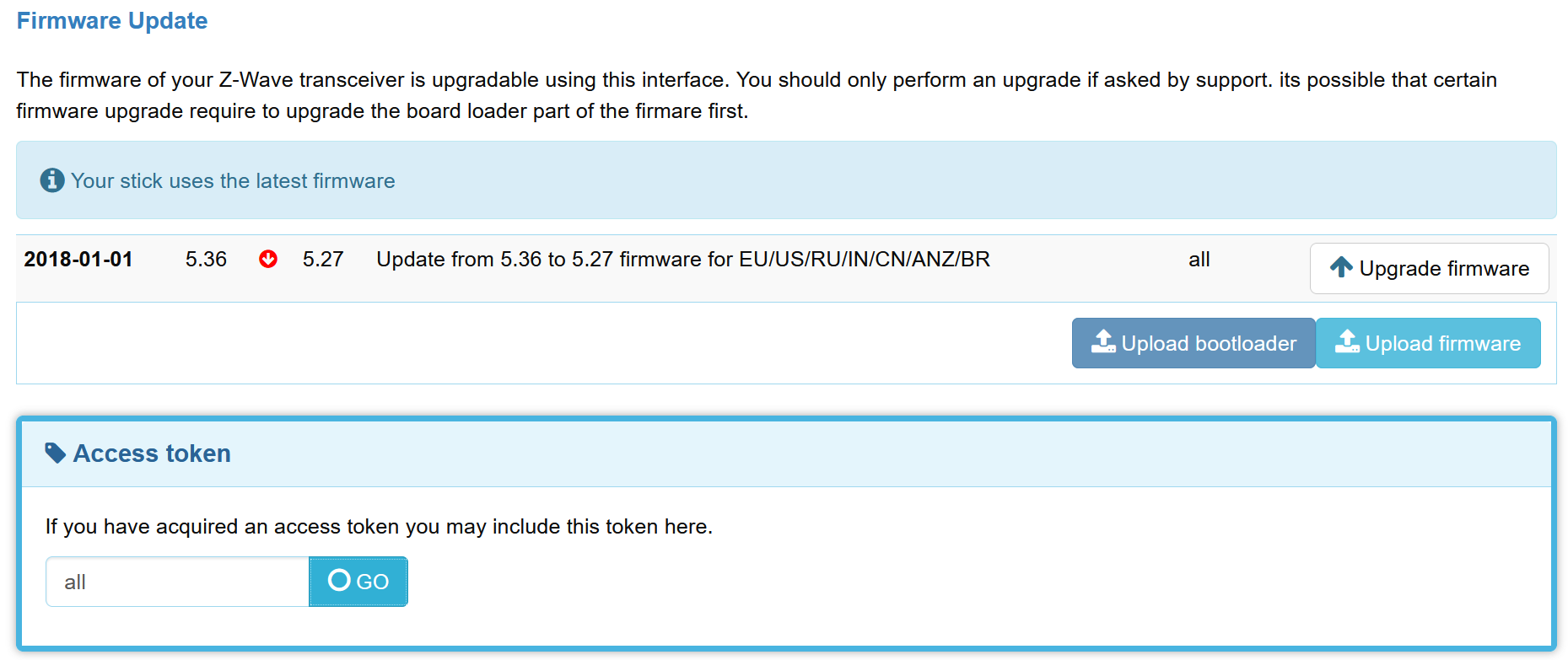

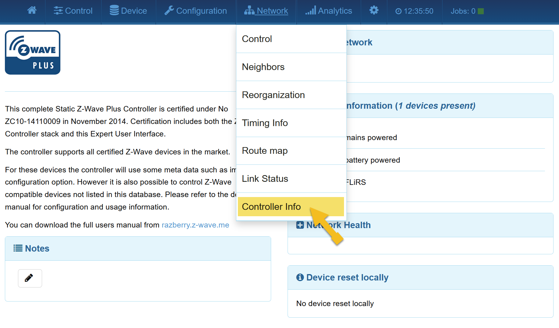

I had the same issue with the PC Controller crashing when it detected UZB. So I read the topic and decided to try an upgrade the firmware in hopes that it will fix the crash. I soon realized that z-wave.me no longer supports the Windows version and the on the website it outdated and no longer works to update the firmware. So I learnt how to install Lubuntu and downloaded and installed v.3.0.0 of the z-way software. However when I try to upgrade the firmware from Expert → Network → Controller Info → Firmware Update, it shows me that it can update the bootloader from 5.25 to 40196 but then when I try to update it it gives me an error Unable to update data. /ZWave.zway/ZMEBootloaderUpgrade
I was wondering if anyone had any tips on how to update the firmware on the UZB to get it to work with PC Controller or if I can use an older version of the firmware which works with PC Controller.
