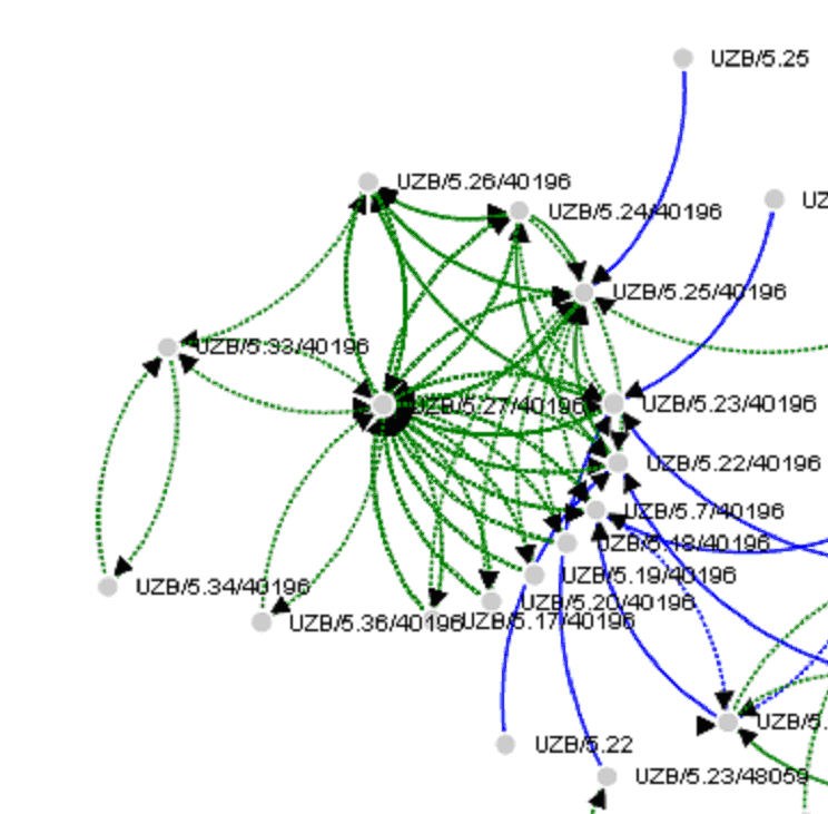

@hunnypuppy
5.34 seems to be OK (based on your steps). But now it isn’t active anymore.
Probably you went: 5.27/40196 → 5.33/40196 → 5.34/40196
And @leif went: 5.27/40196 → 5.36/40196
See here:
You can also view them (active or incative) here.
I don’t want to confuse anyone here, why the 5.27, 5.33, 5.34, 5.36 are now shown as “inactive or hidden”, probably only zwave.me knows it. (6-7 weeks ago, they were “active”).
But (above picture) is the only plausible explanation why some have 5.34 and others 5.36.
