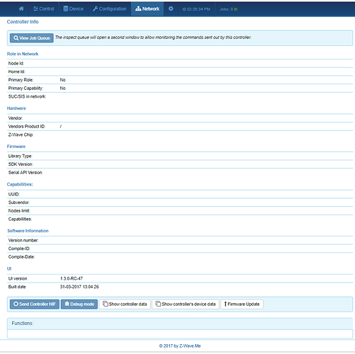

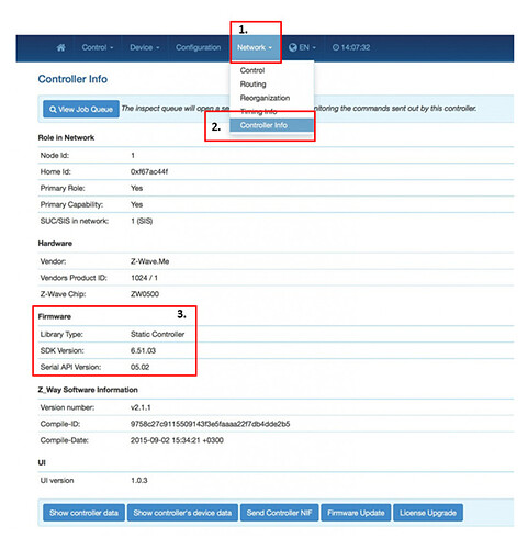

One last question: Which “firmware version” do you use actually? Is 5.32 or 5.37 the latest? See here… (or is it not published on zwave.me site?)
EDIT: Maybe you could also provide such a screenshot (with content :wink: ):
Is it possible to provide your firmware versions (as a file version): e.g. 5.32.zip or .hex
It’s not published on the site. I can’t remember the number at the moment but in Z-Way, on the Firmware Update page, there’s a box labeled “access token”. Enter “all” and you will see all available versions.
Please note that you may have to update more than once to get to the latest version! Make sure you don’t upgrade to “Bridge” firmware, stick with the normal type.

I can’t provide screenshots of the firmware update process because I didn’t take any, so I don’t have any. I did my firmware updates yesterday, today I’m doing something else :).
But I see the firmware update button right there in your screenshot. What are you having problems with?
I’m not at home (atm), so no controller is connected (and then no updates are shown!). And it’s the “Z-Way on Windows” (=2.3.3) version. I don’t have a Linux system running atm. Before I make all the effort with a completely new Linux installation, I wanted to take a look at everything and try it in theory. Maybe it’s possible to use the “Z-Way Windows version (2.3.3)” and put the missing firmware updates in a specific folder to upload them.
It’s NOT possible to use Z-Way for Windows. It’s out of date, and will probably ruin your stick with impunity. If you don’t have a raspberry pi to run it on, I’d skip updating. Anyway, with a raspberry pi you don’t have to make a completely new windows installation, you just download an SD card image that someone else has already made, like Raspbian. :slight_smile:
@leif Ok. I’ll try either Linux or something very different. I’ll inform you then. Thanks :slight_smile:
I see, it seems to be too difficult to open Z-Way again, and doing steps 1-3?
