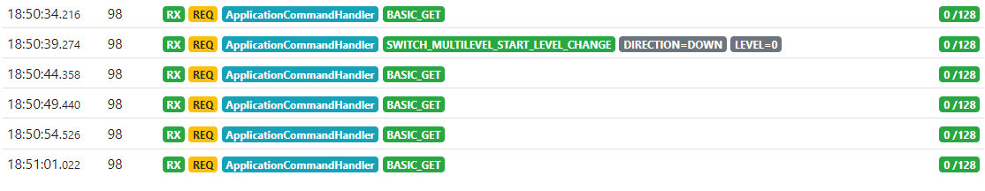

Ok at least now I can see something in the log related to this node (which is 98). But I do not understand what it is. This appears when I click UP or DOWN.
2023-10-14 18:50:34.214 [TRACE] [WaveSerialHandler$ZWaveReceiveThread] - Received SOF
2023-10-14 18:50:34.216 [DEBUG] [WaveSerialHandler$ZWaveReceiveThread] - Receive Message = 01 0A 00 04 00 62 02 20 02 C9 00 7A
2023-10-14 18:50:34.217 [TRACE] [wave.internal.protocol.SerialMessage] - NODE 255: Creating new SerialMessage from buffer = 01 0A 00 04 00 62 02 20 02 C9 00 7A
2023-10-14 18:50:34.218 [TRACE] [wave.internal.protocol.SerialMessage] - Calculated checksum = 122
2023-10-14 18:50:34.219 [TRACE] [wave.internal.protocol.SerialMessage] - NODE 255: Checksum matched
2023-10-14 18:50:34.220 [TRACE] [wave.internal.protocol.SerialMessage] - NODE 98: Message payload = 00 62 02 20 02 C9 00
2023-10-14 18:50:34.221 [TRACE] [WaveSerialHandler$ZWaveReceiveThread] - Message is valid, sending ACK
2023-10-14 18:50:34.223 [TRACE] [WaveSerialHandler$ZWaveReceiveThread] - Response SENT 6
2023-10-14 18:50:34.224 [DEBUG] [nal.protocol.ZWaveTransactionManager] - processReceiveMessage input 0<>128 : Message: class=ApplicationCommandHandler[4], type=Request[0], dest=98, callback=0, payload=00 62 02 20 02 C9 00
2023-10-14 18:50:34.225 [DEBUG] [nal.protocol.ZWaveTransactionManager] - Received msg (0): Message: class=ApplicationCommandHandler[4], type=Request[0], dest=98, callback=0, payload=00 62 02 20 02 C9 00
2023-10-14 18:50:34.227 [DEBUG] [nal.protocol.ZWaveTransactionManager] - lastTransaction null
2023-10-14 18:50:34.227 [DEBUG] [nal.protocol.ZWaveTransactionManager] - NODE 98: Application Command Request (ALIVE:DONE)
2023-10-14 18:50:34.228 [DEBUG] [ng.zwave.internal.protocol.ZWaveNode] - NODE 98: resetResendCount initComplete=true isDead=false
2023-10-14 18:50:34.229 [DEBUG] [ng.zwave.internal.protocol.ZWaveNode] - NODE 98: Incoming command class COMMAND_CLASS_BASIC, endpoint 0
2023-10-14 18:50:34.230 [DEBUG] [ng.zwave.internal.protocol.ZWaveNode] - NODE 98: SECURITY not supported
2023-10-14 18:50:34.232 [DEBUG] [tocol.commandclass.ZWaveCommandClass] - NODE 98: Received COMMAND_CLASS_BASIC V1 unknown command 2
2023-10-14 18:50:34.233 [DEBUG] [nal.protocol.ZWaveTransactionManager] - NODE 98: Commands processed 1.
2023-10-14 18:50:34.234 [DEBUG] [nal.protocol.ZWaveTransactionManager] - NODE 98: Checking command org.openhab.binding.zwave.internal.protocol.ZWaveCommandClassPayload@e7aefc.
2023-10-14 18:50:34.235 [DEBUG] [nal.protocol.ZWaveTransactionManager] - Transaction completed - outstandingTransactions 0
2023-10-14 18:50:34.236 [DEBUG] [nal.protocol.ZWaveTransactionManager] - Transaction completed - outstandingTransactions 0
2023-10-14 18:50:34.237 [DEBUG] [nal.protocol.ZWaveTransactionManager] - ZWaveReceiveThread queue empty
2023-10-14 18:50:34.238 [DEBUG] [nal.protocol.ZWaveTransactionManager] - Transaction SendNextMessage 0 out at start. Holdoff false.
2023-10-14 18:50:34.239 [TRACE] [ng.zwave.internal.protocol.ZWaveNode] - NODE 89: listening == false, frequentlyListening == false, awake == false
2023-10-14 18:50:34.240 [TRACE] [nal.protocol.ZWaveTransactionManager] - NODE 89: Node not awake!
2023-10-14 18:50:34.241 [TRACE] [ng.zwave.internal.protocol.ZWaveNode] - NODE 92: listening == false, frequentlyListening == false, awake == false
2023-10-14 18:50:34.243 [TRACE] [nal.protocol.ZWaveTransactionManager] - NODE 92: Node not awake!
2023-10-14 18:50:34.244 [TRACE] [ng.zwave.internal.protocol.ZWaveNode] - NODE 88: listening == false, frequentlyListening == false, awake == false
2023-10-14 18:50:34.245 [TRACE] [nal.protocol.ZWaveTransactionManager] - NODE 88: Node not awake!
2023-10-14 18:50:34.247 [TRACE] [ng.zwave.internal.protocol.ZWaveNode] - NODE 71: listening == false, frequentlyListening == false, awake == false
2023-10-14 18:50:34.248 [TRACE] [nal.protocol.ZWaveTransactionManager] - NODE 71: Node not awake!
2023-10-14 18:50:34.249 [TRACE] [ng.zwave.internal.protocol.ZWaveNode] - NODE 81: listening == false, frequentlyListening == false, awake == false
2023-10-14 18:50:34.250 [TRACE] [nal.protocol.ZWaveTransactionManager] - NODE 81: Node not awake!
2023-10-14 18:50:34.252 [TRACE] [ng.zwave.internal.protocol.ZWaveNode] - NODE 82: listening == false, frequentlyListening == false, awake == false
2023-10-14 18:50:34.253 [TRACE] [nal.protocol.ZWaveTransactionManager] - NODE 82: Node not awake!
2023-10-14 18:50:34.254 [TRACE] [ng.zwave.internal.protocol.ZWaveNode] - NODE 72: listening == false, frequentlyListening == false, awake == false
2023-10-14 18:50:34.256 [TRACE] [nal.protocol.ZWaveTransactionManager] - NODE 72: Node not awake!
2023-10-14 18:50:34.257 [TRACE] [ng.zwave.internal.protocol.ZWaveNode] - NODE 55: listening == false, frequentlyListening == false, awake == false
2023-10-14 18:50:34.259 [TRACE] [nal.protocol.ZWaveTransactionManager] - NODE 55: Node not awake!
2023-10-14 18:50:34.261 [TRACE] [ng.zwave.internal.protocol.ZWaveNode] - NODE 61: listening == false, frequentlyListening == false, awake == false
2023-10-14 18:50:34.262 [TRACE] [nal.protocol.ZWaveTransactionManager] - NODE 61: Node not awake!
2023-10-14 18:50:34.263 [TRACE] [ng.zwave.internal.protocol.ZWaveNode] - NODE 73: listening == false, frequentlyListening == false, awake == false
2023-10-14 18:50:34.264 [TRACE] [nal.protocol.ZWaveTransactionManager] - NODE 73: Node not awake!
2023-10-14 18:50:34.265 [TRACE] [ng.zwave.internal.protocol.ZWaveNode] - NODE 79: listening == false, frequentlyListening == false, awake == false
2023-10-14 18:50:34.266 [TRACE] [nal.protocol.ZWaveTransactionManager] - NODE 79: Node not awake!
2023-10-14 18:50:34.266 [TRACE] [ng.zwave.internal.protocol.ZWaveNode] - NODE 58: listening == false, frequentlyListening == false, awake == false
2023-10-14 18:50:34.267 [TRACE] [nal.protocol.ZWaveTransactionManager] - NODE 58: Node not awake!
2023-10-14 18:50:34.268 [TRACE] [ng.zwave.internal.protocol.ZWaveNode] - NODE 74: listening == false, frequentlyListening == false, awake == false
2023-10-14 18:50:34.269 [TRACE] [nal.protocol.ZWaveTransactionManager] - NODE 74: Node not awake!
2023-10-14 18:50:34.270 [TRACE] [ng.zwave.internal.protocol.ZWaveNode] - NODE 80: listening == false, frequentlyListening == false, awake == false
2023-10-14 18:50:34.270 [TRACE] [nal.protocol.ZWaveTransactionManager] - NODE 80: Node not awake!
2023-10-14 18:50:34.271 [TRACE] [nal.protocol.ZWaveTransactionManager] - Transaction SendNextMessage nothing
2023-10-14 18:50:39.272 [TRACE] [WaveSerialHandler$ZWaveReceiveThread] - Received SOF
2023-10-14 18:50:39.274 [DEBUG] [WaveSerialHandler$ZWaveReceiveThread] - Receive Message = 01 0E 00 04 00 62 06 26 04 78 00 FF 00 CA 00 FE
2023-10-14 18:50:39.275 [TRACE] [wave.internal.protocol.SerialMessage] - NODE 255: Creating new SerialMessage from buffer = 01 0E 00 04 00 62 06 26 04 78 00 FF 00 CA 00 FE
2023-10-14 18:50:39.276 [TRACE] [wave.internal.protocol.SerialMessage] - Calculated checksum = -2
2023-10-14 18:50:39.276 [TRACE] [wave.internal.protocol.SerialMessage] - NODE 255: Checksum matched
2023-10-14 18:50:39.277 [TRACE] [wave.internal.protocol.SerialMessage] - NODE 98: Message payload = 00 62 06 26 04 78 00 FF 00 CA 00
2023-10-14 18:50:39.278 [TRACE] [WaveSerialHandler$ZWaveReceiveThread] - Message is valid, sending ACK
2023-10-14 18:50:39.279 [TRACE] [WaveSerialHandler$ZWaveReceiveThread] - Response SENT 6
2023-10-14 18:50:39.280 [DEBUG] [nal.protocol.ZWaveTransactionManager] - processReceiveMessage input 0<>128 : Message: class=ApplicationCommandHandler[4], type=Request[0], dest=98, callback=0, payload=00 62 06 26 04 78 00 FF 00 CA 00
2023-10-14 18:50:39.281 [DEBUG] [nal.protocol.ZWaveTransactionManager] - Received msg (0): Message: class=ApplicationCommandHandler[4], type=Request[0], dest=98, callback=0, payload=00 62 06 26 04 78 00 FF 00 CA 00
2023-10-14 18:50:39.281 [DEBUG] [nal.protocol.ZWaveTransactionManager] - lastTransaction null
2023-10-14 18:50:39.282 [DEBUG] [nal.protocol.ZWaveTransactionManager] - NODE 98: Application Command Request (ALIVE:DONE)
2023-10-14 18:50:39.283 [DEBUG] [ng.zwave.internal.protocol.ZWaveNode] - NODE 98: resetResendCount initComplete=true isDead=false
2023-10-14 18:50:39.284 [DEBUG] [ng.zwave.internal.protocol.ZWaveNode] - NODE 98: Incoming command class COMMAND_CLASS_SWITCH_MULTILEVEL, endpoint 0
2023-10-14 18:50:39.285 [DEBUG] [ng.zwave.internal.protocol.ZWaveNode] - NODE 98: SECURITY not supported
2023-10-14 18:50:39.286 [DEBUG] [tocol.commandclass.ZWaveCommandClass] - NODE 98: Received COMMAND_CLASS_SWITCH_MULTILEVEL V3 SWITCH_MULTILEVEL_START_LEVEL_CHANGE
2023-10-14 18:50:39.287 [DEBUG] [ss.ZWaveMultiLevelSwitchCommandClass] - NODE 98: Switch Multi Level start level change, direction = DECREASE
2023-10-14 18:50:39.288 [TRACE] [ve.internal.protocol.ZWaveController] - Notifying event listeners: ZWaveStartStopEvent
2023-10-14 18:50:39.288 [DEBUG] [ding.zwave.handler.ZWaveThingHandler] - NODE 98: Got an event from Z-Wave network: ZWaveStartStopEvent
2023-10-14 18:50:39.289 [DEBUG] [ding.zwave.handler.ZWaveThingHandler] - NODE 98: Got a value event from Z-Wave network, endpoint=0, command class=COMMAND_CLASS_SWITCH_MULTILEVEL, value=DECREASE
2023-10-14 18:50:39.290 [TRACE] [ding.zwave.handler.ZWaveThingHandler] - NODE 98: Checking channel=zwave:device:zwave-controller:node98:blinds_control, cmdClass=COMMAND_CLASS_SWITCH_MULTILEVEL, endpoint=0
2023-10-14 18:50:39.291 [DEBUG] [erter.ZWaveMultiLevelSwitchConverter] - NODE 98: ZWaveMultiLevelSwitchConverter.handleEvent() <<blinds_control>>
2023-10-14 18:50:39.292 [DEBUG] [nal.protocol.ZWaveTransactionManager] - NODE 98: Commands processed 1.
2023-10-14 18:50:39.293 [DEBUG] [nal.protocol.ZWaveTransactionManager] - NODE 98: Checking command org.openhab.binding.zwave.internal.protocol.ZWaveCommandClassPayload@d53628.
2023-10-14 18:50:39.293 [DEBUG] [nal.protocol.ZWaveTransactionManager] - Transaction completed - outstandingTransactions 0
2023-10-14 18:50:39.294 [DEBUG] [nal.protocol.ZWaveTransactionManager] - Transaction completed - outstandingTransactions 0
2023-10-14 18:50:39.295 [DEBUG] [nal.protocol.ZWaveTransactionManager] - ZWaveReceiveThread queue empty
2023-10-14 18:50:39.296 [DEBUG] [nal.protocol.ZWaveTransactionManager] - Transaction SendNextMessage 0 out at start. Holdoff false.
2023-10-14 18:50:39.296 [TRACE] [ng.zwave.internal.protocol.ZWaveNode] - NODE 89: listening == false, frequentlyListening == false, awake == false
2023-10-14 18:50:39.297 [TRACE] [nal.protocol.ZWaveTransactionManager] - NODE 89: Node not awake!
2023-10-14 18:50:39.298 [TRACE] [ng.zwave.internal.protocol.ZWaveNode] - NODE 92: listening == false, frequentlyListening == false, awake == false
2023-10-14 18:50:39.299 [TRACE] [nal.protocol.ZWaveTransactionManager] - NODE 92: Node not awake!
2023-10-14 18:50:39.299 [TRACE] [ng.zwave.internal.protocol.ZWaveNode] - NODE 88: listening == false, frequentlyListening == false, awake == false
2023-10-14 18:50:39.300 [TRACE] [nal.protocol.ZWaveTransactionManager] - NODE 88: Node not awake!
2023-10-14 18:50:39.301 [TRACE] [ng.zwave.internal.protocol.ZWaveNode] - NODE 71: listening == false, frequentlyListening == false, awake == false
2023-10-14 18:50:39.302 [TRACE] [nal.protocol.ZWaveTransactionManager] - NODE 71: Node not awake!
2023-10-14 18:50:39.302 [TRACE] [ng.zwave.internal.protocol.ZWaveNode] - NODE 81: listening == false, frequentlyListening == false, awake == false
2023-10-14 18:50:39.303 [TRACE] [nal.protocol.ZWaveTransactionManager] - NODE 81: Node not awake!
2023-10-14 18:50:39.304 [TRACE] [ng.zwave.internal.protocol.ZWaveNode] - NODE 82: listening == false, frequentlyListening == false, awake == false
2023-10-14 18:50:39.305 [TRACE] [nal.protocol.ZWaveTransactionManager] - NODE 82: Node not awake!
2023-10-14 18:50:39.305 [TRACE] [ng.zwave.internal.protocol.ZWaveNode] - NODE 72: listening == false, frequentlyListening == false, awake == false
2023-10-14 18:50:39.306 [TRACE] [nal.protocol.ZWaveTransactionManager] - NODE 72: Node not awake!
2023-10-14 18:50:39.307 [TRACE] [ng.zwave.internal.protocol.ZWaveNode] - NODE 55: listening == false, frequentlyListening == false, awake == false
2023-10-14 18:50:39.308 [TRACE] [nal.protocol.ZWaveTransactionManager] - NODE 55: Node not awake!
2023-10-14 18:50:39.308 [TRACE] [ng.zwave.internal.protocol.ZWaveNode] - NODE 61: listening == false, frequentlyListening == false, awake == false
2023-10-14 18:50:39.309 [TRACE] [nal.protocol.ZWaveTransactionManager] - NODE 61: Node not awake!
2023-10-14 18:50:39.310 [TRACE] [ng.zwave.internal.protocol.ZWaveNode] - NODE 73: listening == false, frequentlyListening == false, awake == false
2023-10-14 18:50:39.310 [TRACE] [nal.protocol.ZWaveTransactionManager] - NODE 73: Node not awake!
2023-10-14 18:50:39.311 [TRACE] [ng.zwave.internal.protocol.ZWaveNode] - NODE 79: listening == false, frequentlyListening == false, awake == false
2023-10-14 18:50:39.312 [TRACE] [nal.protocol.ZWaveTransactionManager] - NODE 79: Node not awake!
2023-10-14 18:50:39.313 [TRACE] [ng.zwave.internal.protocol.ZWaveNode] - NODE 58: listening == false, frequentlyListening == false, awake == false
2023-10-14 18:50:39.313 [TRACE] [nal.protocol.ZWaveTransactionManager] - NODE 58: Node not awake!
2023-10-14 18:50:39.314 [TRACE] [ng.zwave.internal.protocol.ZWaveNode] - NODE 74: listening == false, frequentlyListening == false, awake == false
2023-10-14 18:50:39.315 [TRACE] [nal.protocol.ZWaveTransactionManager] - NODE 74: Node not awake!
2023-10-14 18:50:39.316 [TRACE] [ng.zwave.internal.protocol.ZWaveNode] - NODE 80: listening == false, frequentlyListening == false, awake == false
2023-10-14 18:50:39.317 [TRACE] [nal.protocol.ZWaveTransactionManager] - NODE 80: Node not awake!
2023-10-14 18:50:39.317 [TRACE] [nal.protocol.ZWaveTransactionManager] - Transaction SendNextMessage nothing
2023-10-14 18:50:44.355 [TRACE] [WaveSerialHandler$ZWaveReceiveThread] - Received SOF
2023-10-14 18:50:44.358 [DEBUG] [WaveSerialHandler$ZWaveReceiveThread] - Receive Message = 01 0A 00 04 00 62 02 20 02 CA 00 79
2023-10-14 18:50:44.361 [TRACE] [wave.internal.protocol.SerialMessage] - NODE 255: Creating new SerialMessage from buffer = 01 0A 00 04 00 62 02 20 02 CA 00 79
2023-10-14 18:50:44.363 [TRACE] [wave.internal.protocol.SerialMessage] - Calculated checksum = 121
2023-10-14 18:50:44.365 [TRACE] [wave.internal.protocol.SerialMessage] - NODE 255: Checksum matched
2023-10-14 18:50:44.367 [TRACE] [wave.internal.protocol.SerialMessage] - NODE 98: Message payload = 00 62 02 20 02 CA 00
2023-10-14 18:50:44.368 [TRACE] [WaveSerialHandler$ZWaveReceiveThread] - Message is valid, sending ACK
2023-10-14 18:50:44.370 [TRACE] [WaveSerialHandler$ZWaveReceiveThread] - Response SENT 6
2023-10-14 18:50:44.371 [DEBUG] [nal.protocol.ZWaveTransactionManager] - processReceiveMessage input 0<>128 : Message: class=ApplicationCommandHandler[4], type=Request[0], dest=98, callback=0, payload=00 62 02 20 02 CA 00

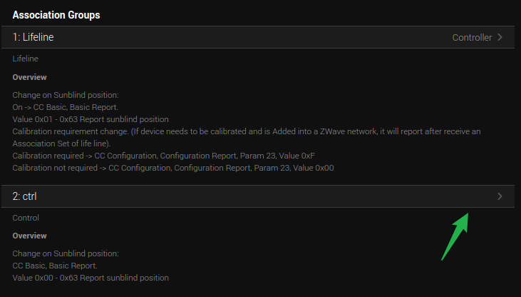

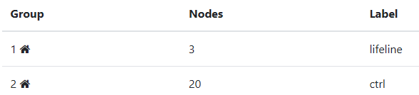

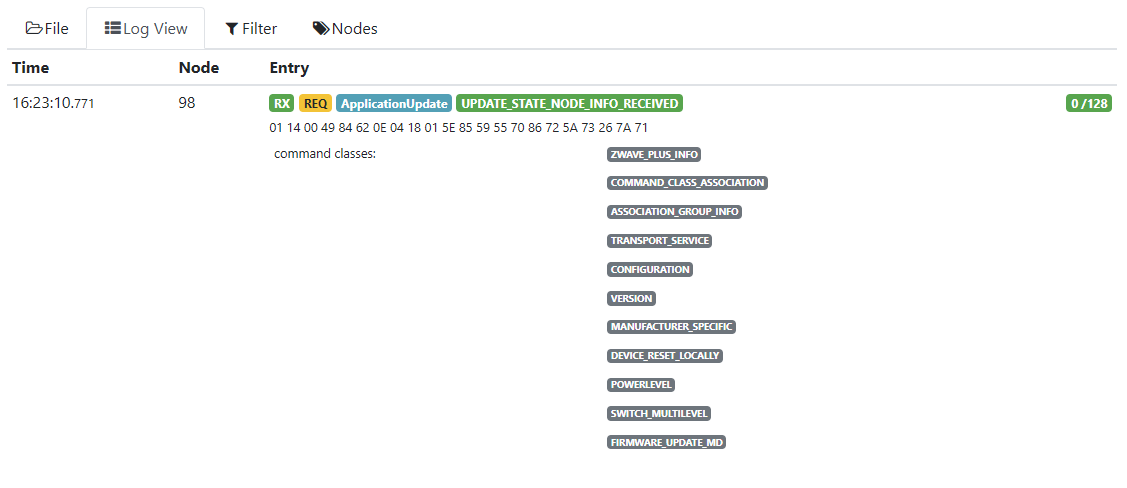

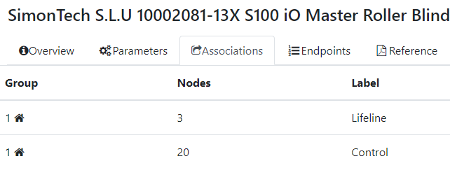

Does this tell you something? Since there is clearly something received when we click the device, it means it’s definitely communicating. But it is not assuming, on the Thing inside OH neither on the Item associated to it, anything at all. Also in the rules, it is not capturing no change at all since I have a “logInfo” there to test if any change happened and nothing at all…
Any help will be much appreciated!
