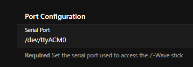

My Port Configurations was /dev/ttyACM0

Now the device is in the dropdown list in the thing configuration from the “Z-Wave Serial Controller” as
/dev/ttyACM0
