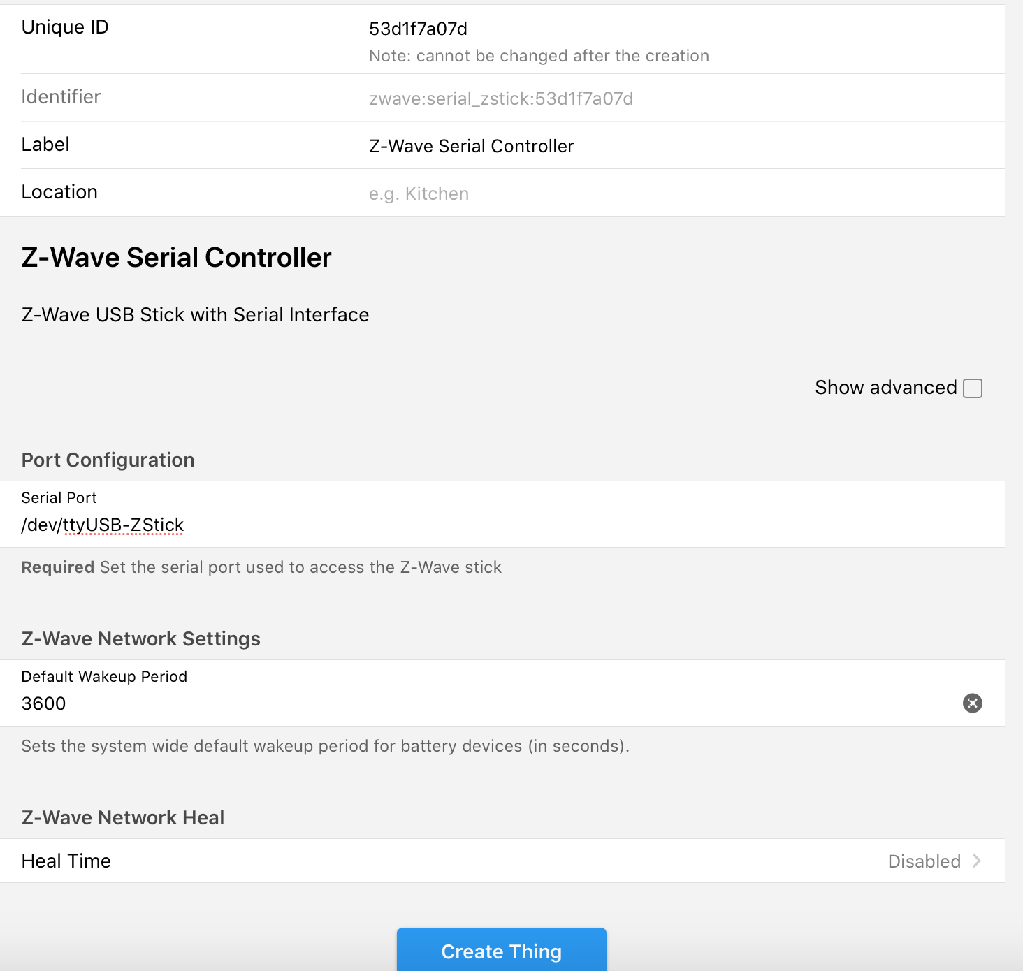

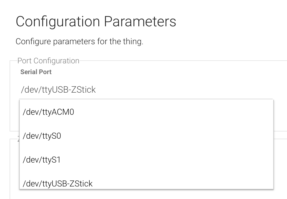

    → Port Configuration (dropdwon Serial Port NOT available)
    → added /dev/ttyUSB-ZStick manually (tested the same with )
    Bridge appears offline in GUI

strange, I enabled
log:set DEBUG org.openhab.core.io.transport.serial
additional output
2020-11-13 16:35:16.575 [DEBUG] [ort.serial.internal.RxTxPortProvider] - No SerialPortIdentifier found for: /dev/ttyUSB-ZStick

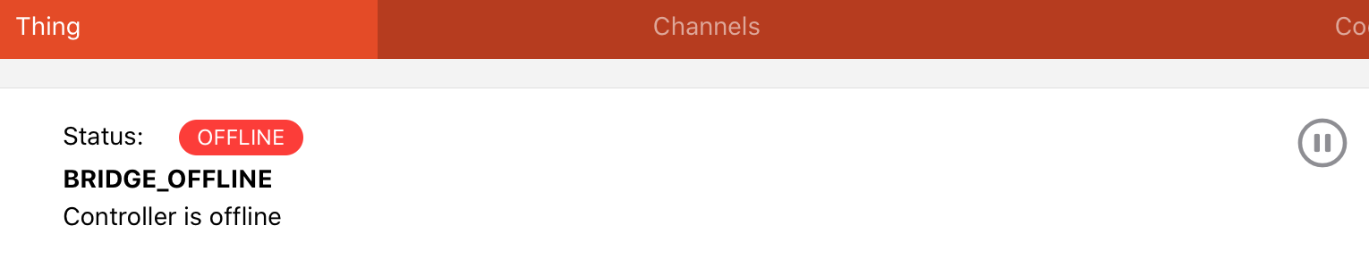

ok, in pictures
The bridge does not come online in OH3, but on the same server with OH2 is works.
And I asked:
“Do you have some hints what i can do (e.g. add some debug to other classes) to find the root cause of my issue”
Why does it work in OH2 and no longer in OH3 on the same HW and OS ?
What can I do (debugging) to get more information ?
Sure - I know what OFFLINE means - both as text and as an image :wink:
Understood - it’s OFFLINE - I got that already :wink:
