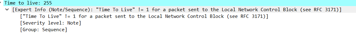

Iv’e found some sensor data in the TCPdump, and I don’t know why but the protocol “rhwois” actually transfers the Data to Port 9898, so I’m assuming, that port 9898 is STILL responsible for data exchange:
And I’ve found a error on the TTL block:
But it’s beeing obviously blocked by monkeycom.
All my sensors worked 2 weeks ago, when I made a Firewallexception for port 9898. They suddenly stopped working, but I don’t think there has been a Gateway update 2 weeks ago or am I wrong?
