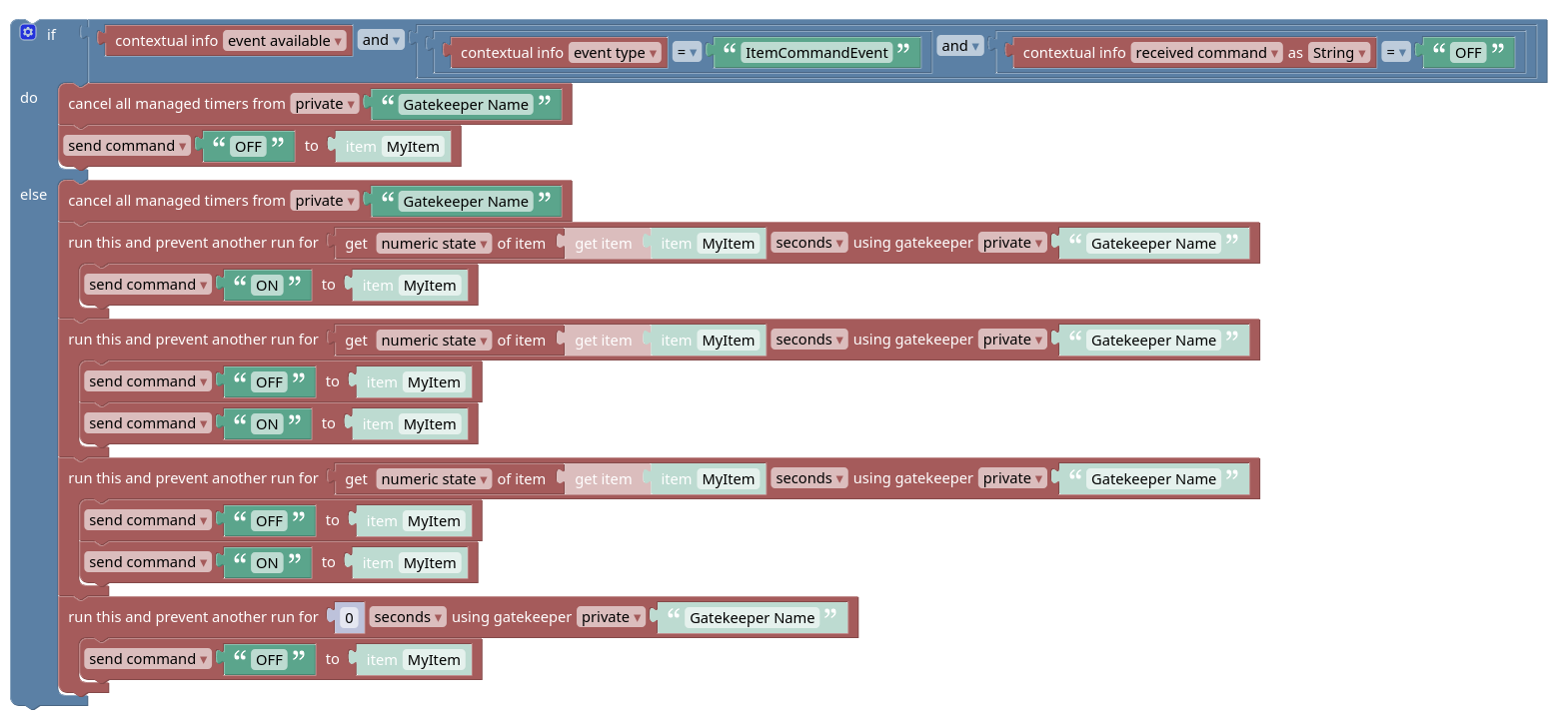

In Blockly the code for the action would be something like this:
Put all the valves into a Group:Switch.
I don’t have suitable Items to show in this example.
In the if block that runs when Irrigation_Manual receives command OFF, you want to send command to the Group Item in place of “MyItem”.

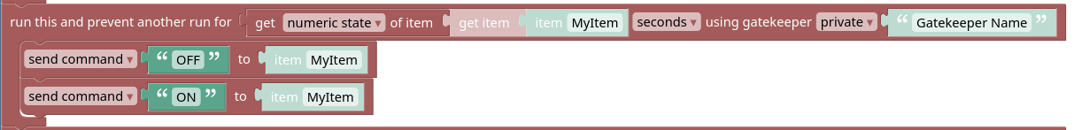

In the else block you’ll replace the MyItem in the call to Gatekeeper with the Number Item that holds the duration the valve should remain open. If it’s a Number:Time Item, make sure to use s as the unit.
The first call to Gatekeeper turns on the first valve so replace “MyItem” with your first valve’s Switch Item. The subsequent calls to Gatekeeper turn off the previous valve and turn on the next ones.

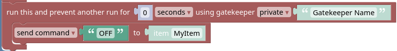

The final call to Gatekeeper just turns off the last valve. Replace all the "MyItem"s as approrpriate.

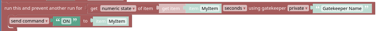

The Start action1 part is
The corresponding Blockly from above is
