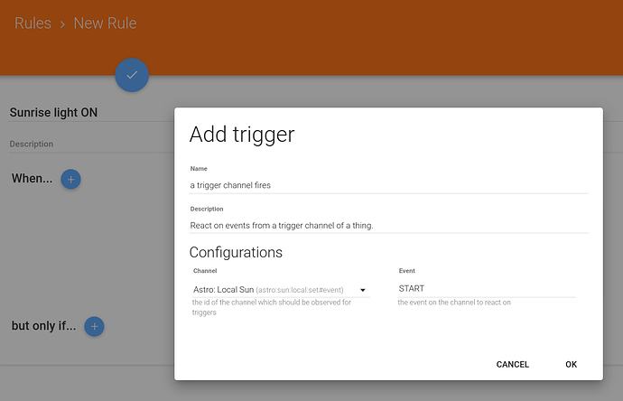

Welcome to the forum! The UI rule editor is a great place to start for people new to openHAB, but it is still being developed and has some quirks. It will be revamped in OH 3.0. You’re welcome to try it, but by far most people are using text based rules using either scripted automation with helper libraries (new rule engine) or the rules DSL (old rule engine). There is not much support in the forum for UI rules, but there’s not much to them either!
Install the Astro binding (ask if you need help), create Things, create Items, and link the Items to the Channels in the Things. Install the new rule engine. Open Paper UI and create a new rule that looks like this…
Then create another rule like this…
There are some cron expression calculators listed in the Trigger documentation (see below).

Ok, so basically in my case I had to use trigger channel instead of status changed or updated.
And what’s the reason to use cron trigger?
5iver
(Scott Rushworth)
February 8, 2020, 3:09pm
#8
The one rule will turn the light ON at sunset. The other one will turn the light OFF at 1:00AM. Isn’t that what you were looking to implement?
