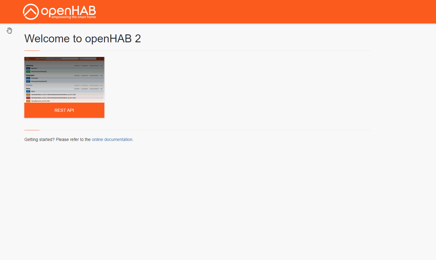

Does someone know why this happened? How can I solve it?
I cleared the cache also. I now have no openhab ui’s at all. My cache folder has an “org.eclipse.osgi” file in there, but nothing else. My tmp folder doesn’t have it either. Do I need to reinstall everything again. I’m a newbie, so I haven’t made too many files yet.
You need to be patient: all packages needs to be downloaded again after the folders got emptied, this can take a while, especially if you are on a slow computer.
This happened to me again. I have cleared the cache, now the PaperUI is not visible on the Dashboard, and when accessing directly, the openHAB theme is also gone from the PaperUI. What could I do to get it running again?
The service tells nothing unusual. The PaperUI is still usable, only the “icon” gone from the Dashboard and the theme is gone from the PaperUI (now it is blue), but works fine…
