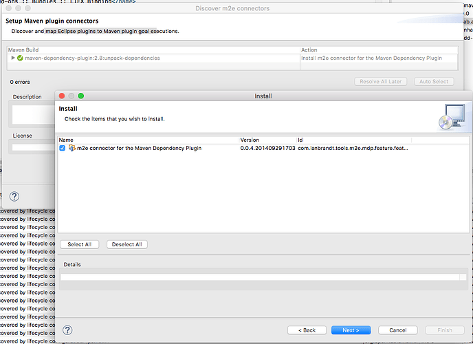

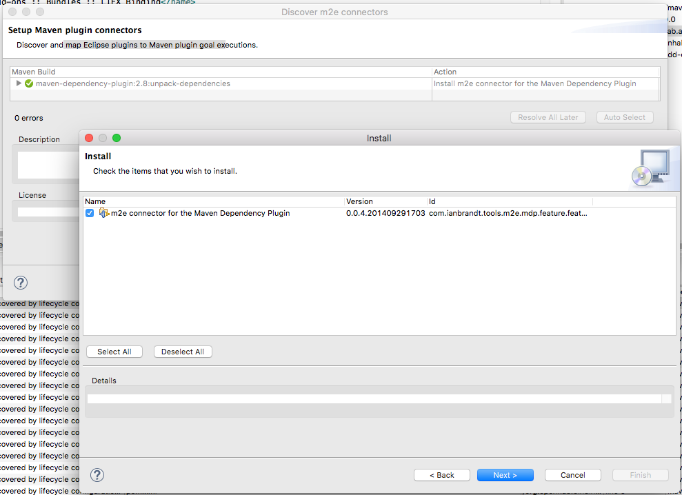

Thanks for the feedback! To my surprise, Eclipse actually solved my problem for me. I hovered over one of the problematic pom.xml’s errors and clicked the suggested solution (I don’t remember what it was called EDIT: “Discover new m2e connectors”), which brought me here:
After installing, accepting the license, and restarting Eclipse, I got a runtime error (“Executing […] jar:jar goal”, not enough heap space).
After restarting Eclipse again, everything magically worked.
Again, thanks for your help, I hope this helps someone else, too!
