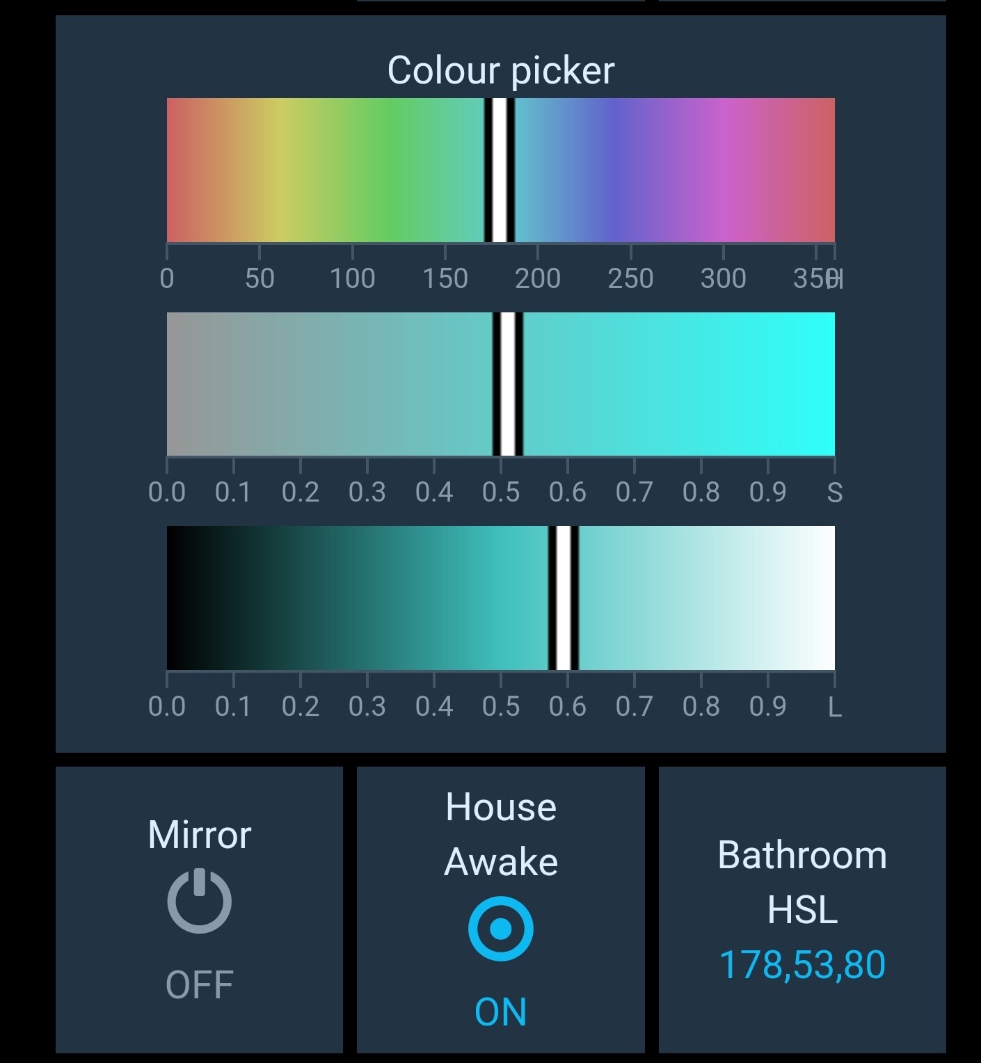

All I do is to create a UI panel with a Colorpicker and a dummy, assigned to the same Colour Item.
Then I simply copy whatever the Dummy widget shows into the NodeRed payload.
For example
This value would be
178,53,80
Without any quotes, assigned as a String
