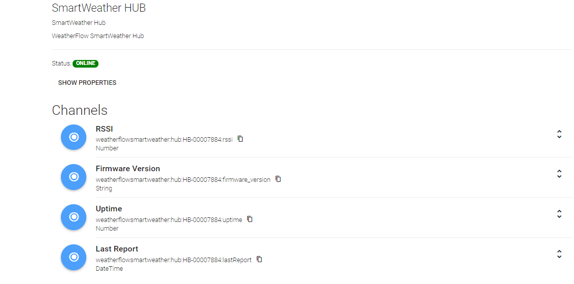

PS. I still cannot get data from HUB for some reason. I have it configured as below:
Number:Dimensionless SmartWeatherHub_rssi "RSSI" (Group_Weatherstation) { channel="weatherflowsmartweather:hub:HB-0000XXXX:rssi" }
String SmartWeatherHub_firmware_version "Firmware version [%d]" (Group_Weatherstation) { channel="weatherflowsmartweather:hub:HB-0000XXXX:firmware_version" }
Number:Time SmartWeatherHub_uptime "Uptime" (Group_Weatherstation) { channel="weatherflowsmartweather:hub:HB-0000XXXX:uptime" }
DateTime SmartWeatherHub_lastReport "Last Report [%1$tY-%1$tm-%1$td %1$tH:%1$tM:%1$tS]" (Group_Weatherstation) { channel="weatherflowsmartweather:hub:HB-0000XXXX:lastReport" }

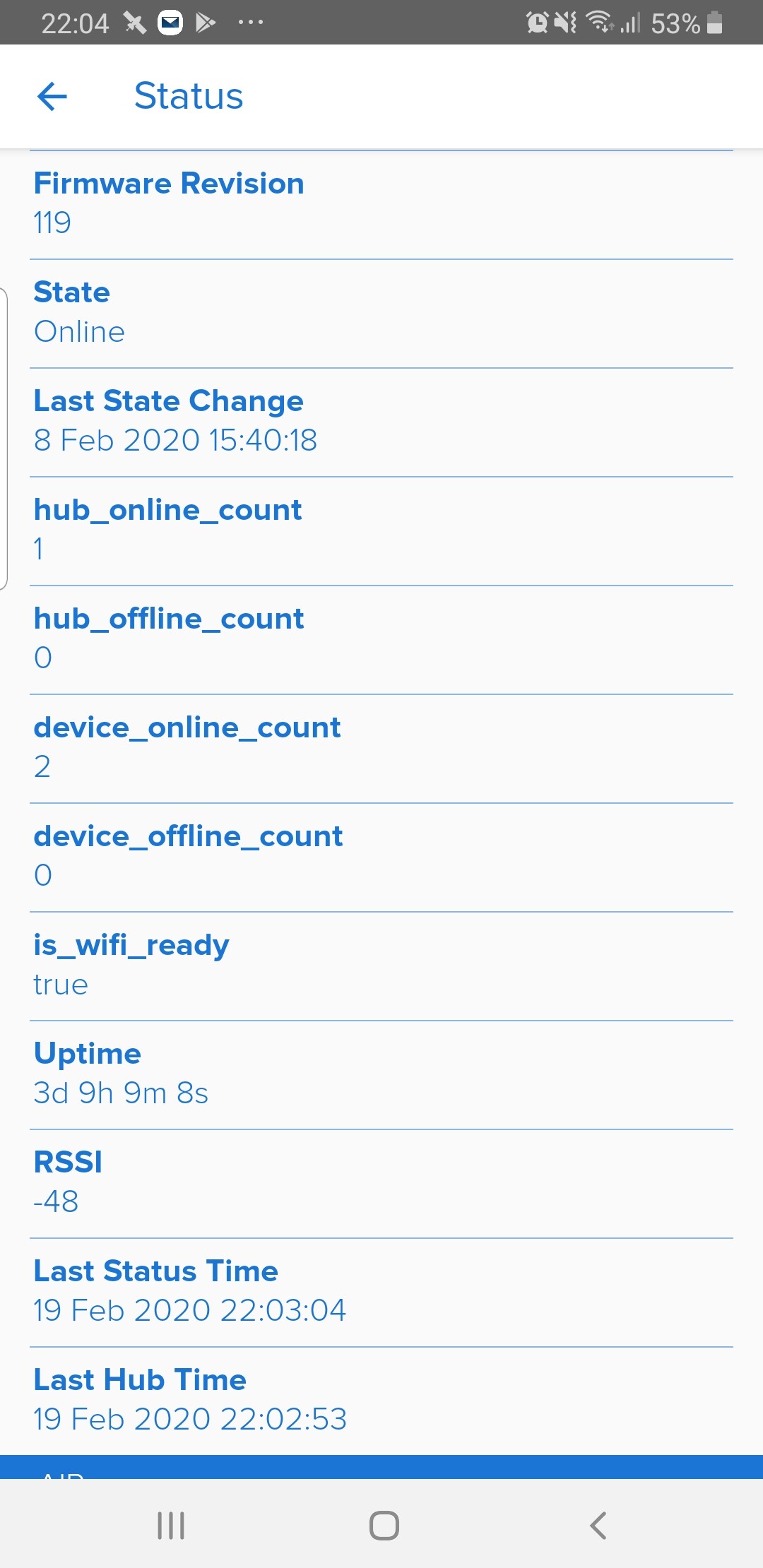

I can see only this:
I’ll have to take a look at that problem. I’m not using .item files, and my hub does provide reports. The data types for your items look okay. Is it possible you’re not using the right channel names?

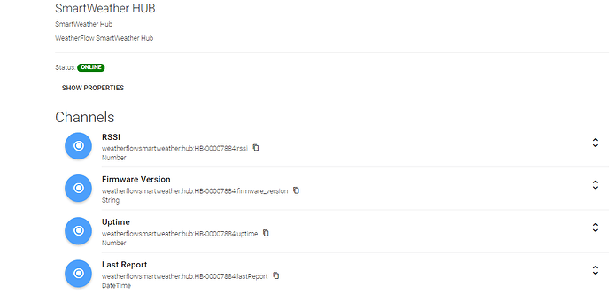

Channels seems to be ok
Hmm… they do look okay at first glance. You cleared out your openhab cache, right? Have you tried removing those items and re-creating them? I’ve had problems when items change with new versions of bindings but the item definitions don’t update so there are mis-matches.
I have fresh OH installation 2.5.1-2 and new WF HUB because the previous one was faulty. Nevertheless issues with data from hub channels remains the same.
Hmm… that’s pretty strange. What firmware version are you running on your hub?
