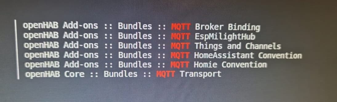

A friend has the same version (also docker) installed and his setup includes these bindings.
Why is it different and how can I reinstall the missing ones (They are not in the gui to choose)

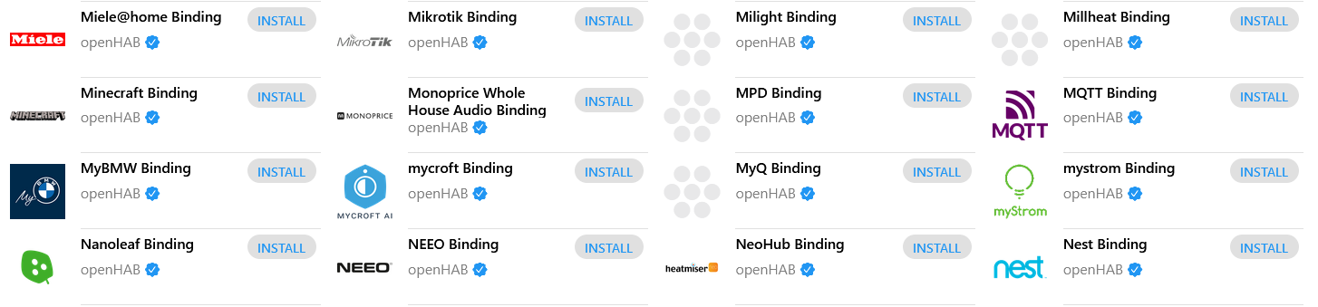

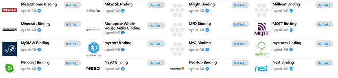

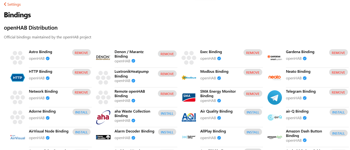

Show a screen shot of your Settings → Bindings page.
Do you now or have you ever put a jar file or kar file into the addons folder?

This is the settings binding
here is the uninstalled part with letter “M”
the addon folder is empty and I never added a file there
Is there nothing in the log before that? There are usually a few lines before the “Loading model” lines appear typically.
OK, those screen shots show that the MQTT binding simply is not installed (second row, last one on the right in the second screenshot). Install it and watch the logs for errors. Report any that appear. If not errors appear, restart OH and watch the logs for errors.

This is the bundle:list of my friends 3.4.0.M4 docker container:
I believe you, but I need the logs.
