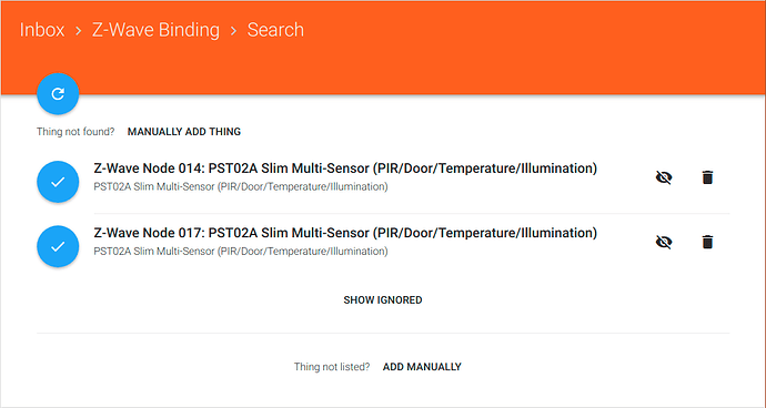

While playing with a Z-Wave device I have removed and re-added it a couple of times. Now the real node ID is 18, but I keep getting its “phantom”, obsolete, copies as nodes 14 and 17 in my inbox. This happens every time I run thing discovery.
I tried to delete them while the Z-Wave controller is in the exclusion mode, but it didn’t help.
How can I remove them permanently (without having to “Ignore” them)?
