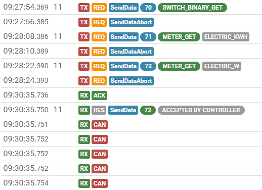

There’s certainly some strange stuff happening. I’ve not looked at huge detail at the log, but the following makes me think there’s something wrong with the hardware/OS and things are getting blocked -:
Here we see the binding send a request - it fails and the binding tries another request, and then again. Each time there is no ACK from the controller which should arrive quite quickly. Then we get a bunch of CAN messages all received very quickly - probably these are coming from the previous messages where we did not receive the ACK. I’ve no real idea why this is - the binding logs messages when it sends and receives the data, but maybe the OS is running slow for some reason at this point and things are getting blocked, we then swamp the controller, and it gets upset and sends all the CAN messages (CAN means that the controller received stuff out of order, but as we see, when we receive them, we’ve actually not sent anything).

I’m not at all surprised. From the log I looked at earlier, it appears that the issue is with messages getting queued somewhere - the most likely issue is the host computer or something in openHAB hogging the processor. My guess is that this is causing things to run slow and queue all the serial traffic. These all finally get sent to the controller, and it is then unhappy with the sudden deluge of data being sent.
