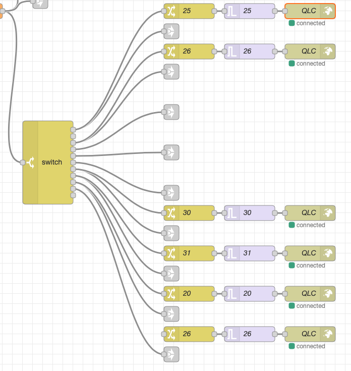

Here’s the nodeRED logic using web socket out nodes:
If anyone else is looking into trying QLC+, I will write up a tutorial once I’ve gotten my setup stable.
That’s excellent :slight_smile:
How are you structuring the payload for the websocket?
Sorry, I’ve been preoccupied lately and forgot to respond to this!
I’ve updated it to remove the change node. I can accomplish everything I want using just the trigger node.
Screen Shot 2020-04-11 at 00.46.25

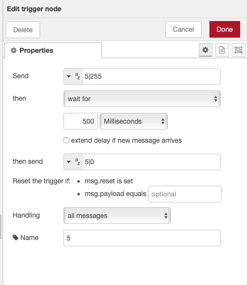

This is what the trigger node looks like:

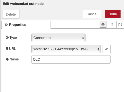

This is what the websocket config looks like:
QLC+ states in its documentation that to actuate a button the software expects a value of 255 followed by 0, hence the trigger node. As for 5, that’s the name of the appropriate widget (in this case, it corresponds to the “stage” scene I created in QLC and added to the virtual console:
I obtained the widget number using the API you referenced earlier:
