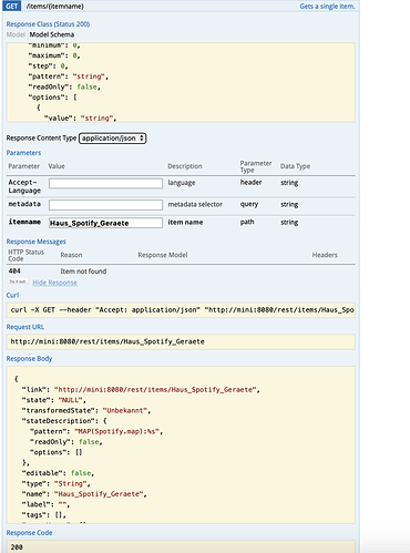

i tried it with item state and the item i linked to the devices channel. it does only give back the current device. or what do i have to do differently? thank you!
What do you mean by tried
i opened rest api and navigated to the items section then chose item state and entered the item i linked to the device channel
Use the API without state
Are you sure you have any active devices? Check with trace log level to see what spotify returns. Im not sure the map transform has anything to do with it, but to check remove it.

You should get them from the binding (and also not needing the MAP pattern) Do you by any chance have the AmazonEcho
or onewire
binding installed?
Hello
I have the amazonechocontrol binding installed.
And i created a String Item for both - devices and playlists.
What should the rest api respond?? a comma separated list of devices in that string item or am i getting something wrong?
I think this might be caused by the amazonecho binding. If you can temporary disable/remove this binding just for checking if that makes a difference.
String item is ok. In sitemap it should be a Selection. It should return a key-value list in the options section.
yep, it works now …
Ok. Recently a fix for this on the amazonecho binding was merged. It’s in 2.5.0-SNAPSHOT version. If you’re running a 2.5M2 version you could download the snapshot jar version of the binding and manually install it (or update SNAPSHOT if you’re running SNAPSHOT) (Although I would not recommend to just move to snapshot versions in general).
