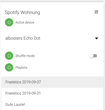

I did integrating the binding today. So far all works but I get the same issues @Andrew_Pawelski and @nolan_garrett had regarding playlists and active devices. For both I can see and select values in paper UI under “Control” but I can’t select and see sth. in Basic UI. There those lists are blank.
I don’t have the alexa binding running. I assume it is the same problem they had. Do you have any idea what could face the issue?

Did you configure the items as Selection on the sitemap?

yes I did.
.items
String spotifyPlaylists     "Playlists [%s]"       {channel="spotify:player:OpenHab:playlists"}
.sitemap
Selection item=spotifyPlaylists
So it should work, but nothing is shown.
If it does work in PaperUI than it’s not the same problem as reported earlier. As that would result in not showing playlists or devices anywhere. So I don’t know what the problem might be. Try editing the sitemap file and see it it gives any errors in the log when you save the file.
I’m a bit lost with all those bridges and devices. How can I switch playing to a certain device via a rule? Which channel should I use ? From the readme it seems that i need devices channel, but what is the full path ? e.g. spotify:device:spotify:ddf0:devices ? Should I then configure a string item and sendCommand to that item?
Thanks for your reply, but this didn’t change anything, obviously. As you can see, playlists are shown, in Basic UI not:
I checked the sitemap, it is the same as shown in the binding examples - so it should work. No error messages after saving etc.
When removing the “s” in the item file I get
Exception while formatting value 'spotify:playlist:0fa5pNuP68eDpD9aajqaYz' of item spotifyPlaylists with format '%': Conversion = '%'
After entering the “s” into [%s] the message is not shown any longer, but still not list for devices nor playlist. How is your configuration for that?

I don’t know why it doesn’t work. Do you have the latest version of the binding? That the only thing I can think of or a typo in the sitemap causing it not to load (correctly)
I have Version 2.5.0.201909061126.
Gerade mal einen Test im HabPanel gemacht, hier geht es auch. Bekomme 9 Playlists angezeigt. Devices ebenfalls.
Here is the hole config:

Hope you have an idea :slight_smile:

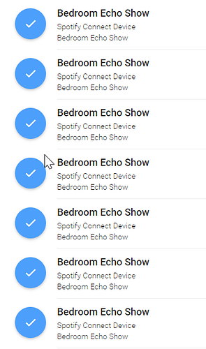

Does anyone know why my inbox in the PaperUI keeps filling up, it is driving me a little crazy :crazy_face:
Any help would be much appreciated, thanks.
2019-09-28%2016_49_27-Paper%20UI
Which version of openHAB or which version of the binding? An earlier version of the binding used the Spotify Id as identification. Some services give a new Id each time you restart the device. The latest version of the binding uses the name so it should not rediscover the same device multiple times.
