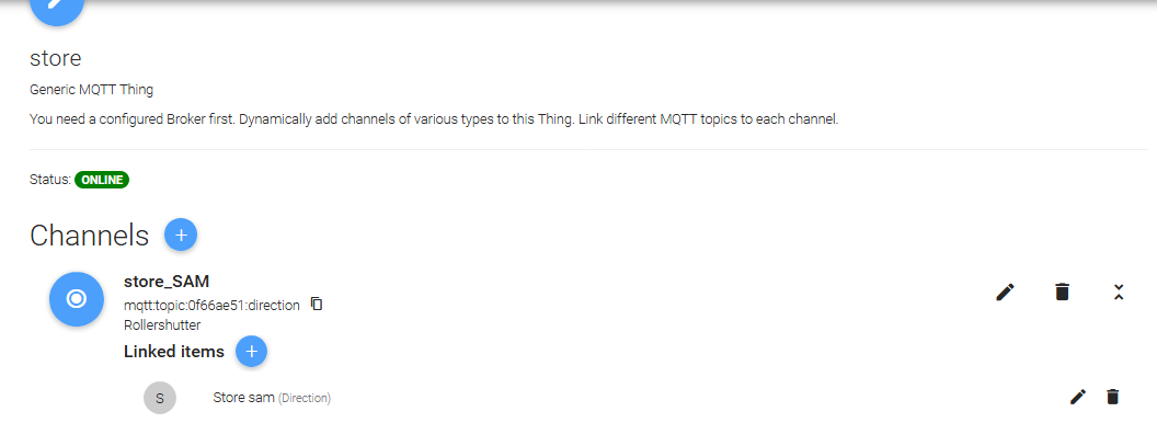

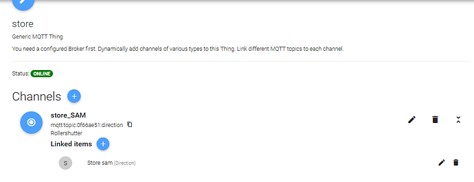

I succeeded in integrating my Zemismart vertical shutter motor in openhab thanks to the AgentK binding, -I found my secret key etc …,
-I have configured my broker correctly,-configured my MQTT thing like this:
,with a rollershutter ID channel type
  • created my articles like this:
    Dimmer Direction "Store sam" {channel="mqtt:topic:0f66ae51:direction"}

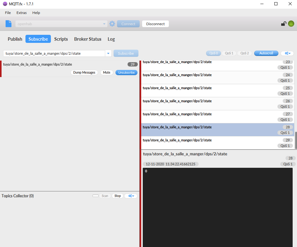

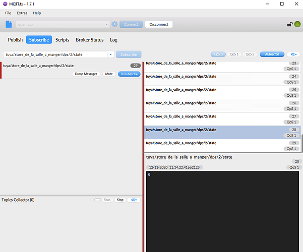

-I noticed while running MQTT fix that the topics of my device were tuya / “name” / dps / 2 / state, this one returns a number value.
My problem is the following, when I activate my roller shutter via the tuya application, I see the change of values ​​of my MQTT fix topic, on my sitemap I also see that the switch opens and closes, however I can’t send a shutter command from openhab to my roller shutter, what am I doing wrong with my rule?

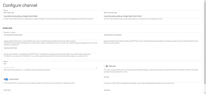

Solved like a dummy i check "is command " in the state status of the MQTT things, to trigger my roller shutter i use the “tuya/store_de_la_salle_a_manger/dps/2/command” set in like a dimmer
