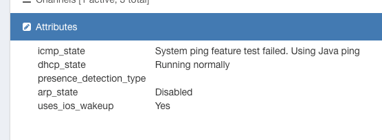

Currently I’m stuck at the binding not working at all.
arping does not work on Mac. brew install arping works, but running it causes an error with some library and I wasn’t able to find anything helpful online.
I set allowSystemPings=false but I wasn’t able to find anything in the logs that suggests it actually does ping the computer (previously I at least got warnings about arping).
Some status info from habmin
