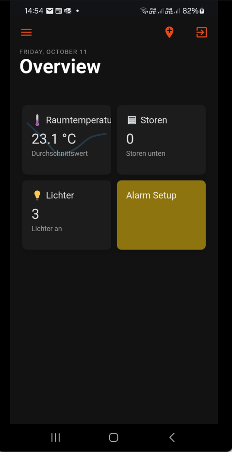

In the image we have three instances and want to switch from instance 1 to instance 2
The message is that an empty sitemap list is sent. However, we don’t use sitemaps but the main ui.
If we clear the cache instance 2 will show up.
