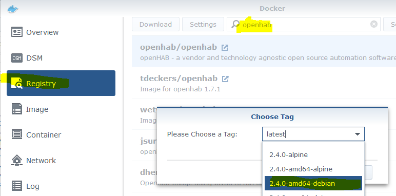

First, if you don’t already have docker, install it. Then, in docker, click on registry and in the seach box type openhab.
It’ll download and then appear in the “image” section of docker. Give it some time to fully download.

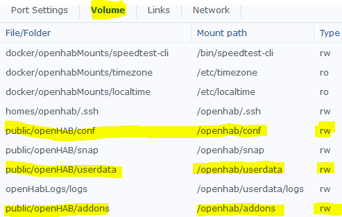

If you do use public, your openhab configuration lives in /volume1/public/openHAB
you’ll need to map /volume1/public/openHAB/addons userdata and conf to their respective folders under /openhab - more on this is a second
Once fully downloaded, select it and click “launch.” Give it a name and click “Advanced Settings” and then the Volume tab. Ignore the localtime and timezone entries for now, focus on userdata, addons, and conf.
If you know what I’m doing there, great. If not, don’t worry about it right now.
Make yours look like this:

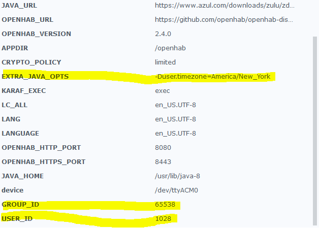

Also, now is a good time to mention you should have an “openhab” user and “openhab” group created through the control panel. If you created them through ssh and they’re not visible through control panel, fine. Make a note of the openhab UID and GID. (you can find these in /etc/paswd and /etc/group find openhab and look for the first number:
mine is 1028 - > UID for openhab)
Back to docker, click on the “Environment” tab. Change the highlighted settings to your environment:
Ignore the device one, i don’t think that does anything - we’ll get to that later
Then click “Apply” and “Next” but uncheck the box for running the container and finally click “Apply.”

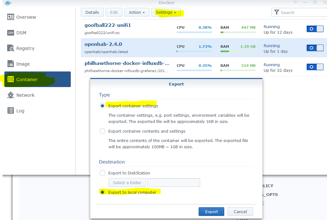

Next we hand edit the container file to make life a little easier.
Still in the docker app click on the “Container” tab on the left side and select the container you just created.
Click “Settings” then “Export” and download the config to your local computer
Open the json file that you just downloaded in your favorite editor (notepad++ ?)

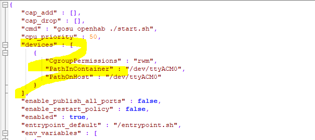

Now is the time we add the z-wave stick if you have it. At the top of the file, make yours look like this, adjusting for your own system:
   "devices" : [
         "CgroupPermissions" : "rwm",
         "PathInContainer" : "/dev/ttyACM0",
         "PathOnHost" : "/dev/ttyACM0"

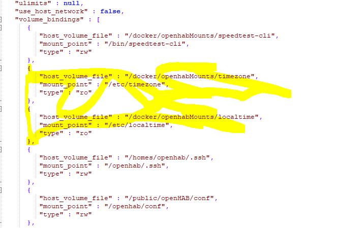

You also need to add localtime and timezone which is either a pain or not really possible through the UI.
Find in your json file the section that looks like this:
That’s not exactly right in the picture but it’s corrected here in the text for you:
         "host_volume_file" : "/etc/timezone",
         "mount_point" : "/etc/timezone",
         "type" : "ro"
         "host_volume_file" : "/etc/localtime",
         "mount_point" : "/etc/localtime",
         "type" : "ro"
Save the file. Back on the synology using “File Station” upload the file you just saved. Then in docker delete the container you created. Once deleted, click settings at the top and Import. Point it to the file you uploaded with file station. You’ll have a new container with your custom settings.

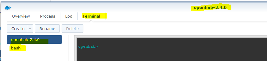

Now might be a good time to shut down the openhab package. After that’s off, you can start that docker container. On the running container click “Details”
Then you can look at the terminal and create a bash terminal if you want.
Here you see a karaf console and a bash console. You’ll probably see a bunch of errors. A lot of the config files were customized for the synology install. You’ll need to hand edit a lot of those files to fix all the paths. It’s a pain, but you do it once and it’s done.
