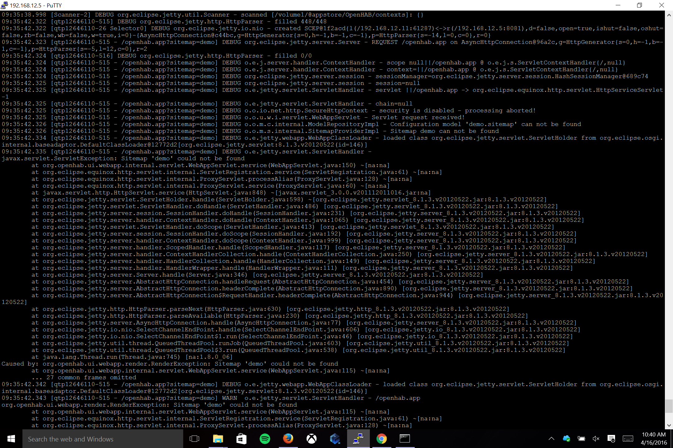

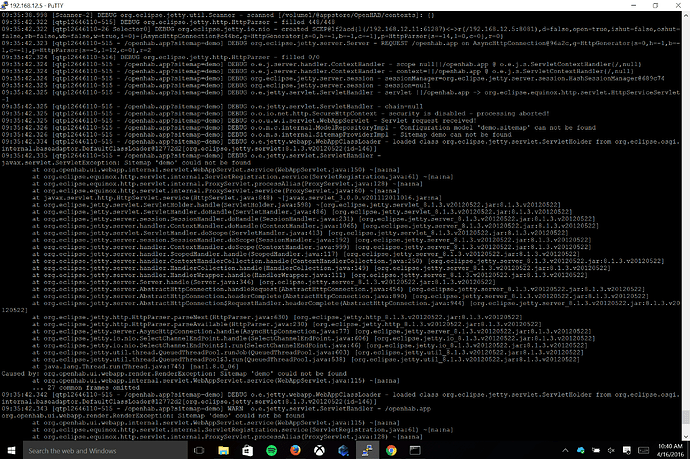

Is anyone else having issues getting OpenHAB 1.8 on DSM 6.0 to see the sitemap file? I copied over the demo configurations and addons folders to a few locations with no luck:
/volume1/public//OpenHAB
/volume1/@appstore/OpenHAB
I see the symlinks pointing to the first path above, but i tried replacing the symlinks with actual folders. I verified openhab user in DSM has access to the shared public folder i created. ive stopped/started openhab multiple times and even uninstalled and reinstalled a few times. openhab 2.0 beta wont start at all so im back to working on 1.8.
im on a Synology DS213+ btw…
id like to add that my sitemap filename is demo.sitemap and my url is http://:8081/openhab.app?sitemap=demo
Here are the logs when refreshing the webpage
admin@DiskStation:/volume1/@appstore/OpenHAB/logs$ tail -f openhab.stdout
