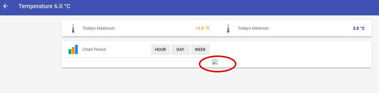

All working fine with the exception of rrd4j graphs under the normal Synology account (if I start the service from “Package Center”) I get the valuates but the graph is showing a missing graphic icon. This happens on the demo install to.
But if I start the OpenHAB2 service from SSH with root access there is no issue and graph will be ok.
command is: “sudo ./start.sh” in the openhab directory (/volume1/@appstore/openHAB2)
I suspect a permission issue but I can’t figure it out.
