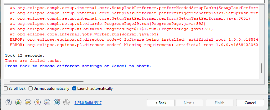

i can’t install eclipse setup, i selected all needed tasks, but still there is an error, can someone help me.

What module/artifact reference is stated after the last error line ?
ERROR: org.eclipse.equinox.p2.director code=0 Missing requirement: artificial_root 1.0.0.v1658422062.....
Perhaps that requirement is no longer needed and can be removed from your setup file. I can remember (old eclipse smarthome ide) somewhere in the past, this was happened before.
hallo peter ,
thanks for the Answer, it´s (ERROR: org.eclipse.equinox.p2.director code=0 Missing requirement: artificial_root 1.0.0.v1658591478264 requires ‘org.eclipse.equinox.p2.iu; org.eclipse.mylyn.java_feature.feature.group 0.0.0’ but it could not be found)
Well. I guess you need assistance from the ones that knows how to define a setup far better then me.
At first glance, It appears also to me, that your set-up (check xml files) may be out of sync.
It’s a namespace=‘org.eclipse.equinox.p2.iu’ (installable unit) issue that’s likely referenced in virtually every module op openHAB.
Perhaps you are using the wrong target-arechitecture (things like x86, x32, x64 etc.etc.)
Try to search for that specific error message (and likely get tons of hits).

Getting this error while downloading the openhab codes with eclipse.
Please help.
ERROR: org.eclipse.equinox.p2.director code=10053 Cannot complete the install because one or more required items could not be found.

ERROR: org.eclipse.equinox.p2.director code=0 Software being installed: artificial_root 1.0.0.v1662617374310
ERROR: org.eclipse.equinox.p2.director code=0 Missing requirement: artificial_root 1.0.0.v1662617374310 requires ‘org.eclipse.equinox.p2.iu; org.eclipse.mylyn.java_feature.feature.group 0.0.0’ but it could not be found
Took 43 seconds.
There are failed tasks.
Press Back to choose different settings or Cancel to abort.
