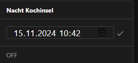

Hello
I am trying to use the #3 you proposed. I installed both widgets but I do not fully understand how they works. I can select a date and link it to an item so far. In the widget “DateTime List item” I see the current state of the item. When I press afterwards to the checkmark symbol I get an error message “comunication error” and the inserted date/time is removed.

There isn’t anything special about my widgets. They just do a tiny bit of configuration of features that are built in to MainUI and the underlying F7n framework. If it’s not working, there’s a problem with something upstream from the widget.
I think I saw an issue go by that mentioned that if you do not enter anything and press the check an error will be generated. But if you select a DateTime and then hit the check it should command the Item with the newly selected date time.
Once you have the DateTime Item populated, you use that Item as the Item in a Time is <Item> trigger. Then that rule will run a the time carried by the Item.

In my case it is different. I do select a valid date and afterwards I hit the check. See this:
When I use such DateTime item populated with a specific date and used that item in a rule, will the rule only trigger once at that day I configured? I would like to have a rule which triggers such item always at the same (night) time for example.
Again, there isn’t anything I can do about this. It’s not implemented by the widget. It’s implemented by the F7 framework. All the widget does is set the property to show the date time picker.
There is a promament “Time Only” option.
You can also use the timepicker widget from the marketplace and add it as default standalone widget. We use it within the semanticHomeMenu project for time schedules for rollershutters.
